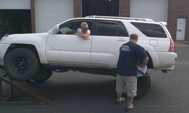

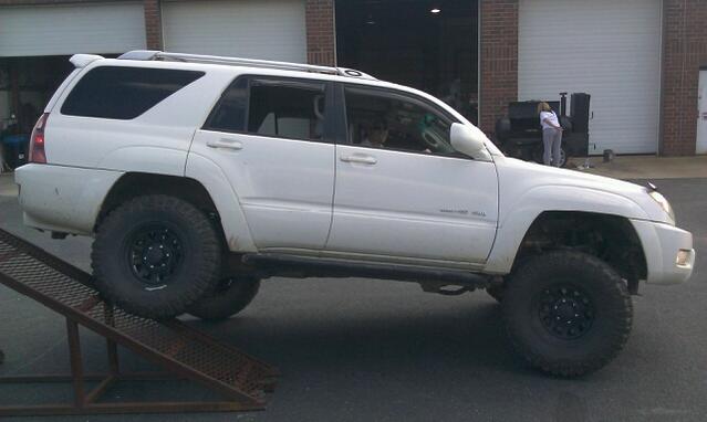

Lets see some pics of those ext. travel shocks in use! How well does the rear flex with the stiff 896's?
They seem to work perfect together!!! pics/videos coming soon, got a few from this past weekend run with Superman at Uhwarrie!! I've just got to get them rendored right so there worth postin up ****ty phone vid's you know lol. I'm still running factory sway bar end links so adding extended links may prove to required slightly taller springs or a spacer but we'll know pretty soon if medic over at toyota120 can get his shipped to me!!
pics... to bad the guy measuring is standing infront of the rear ill have to grab some better shots
