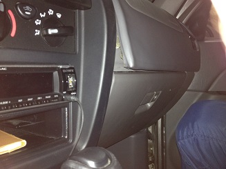

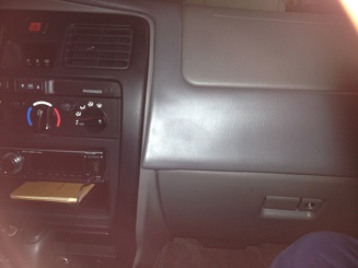

Search engine didn't help much. It seems to be common for the dash between glovebox and airbag to pull up. On mine there are two clips that look like they are totally bent out of shape - I am the only owner and it has never been apart but the clips are pretty useless. Has anyone found a solution? I am thinking it would be fairly easy to drill a hole behind the dash and have a bolt attached to the dash and screw it down. However I cannot find a good way to mount the bolt to the backside of the dash with coming out into the cockpit. Ideas/thoughts?
Pulling loose and the clip

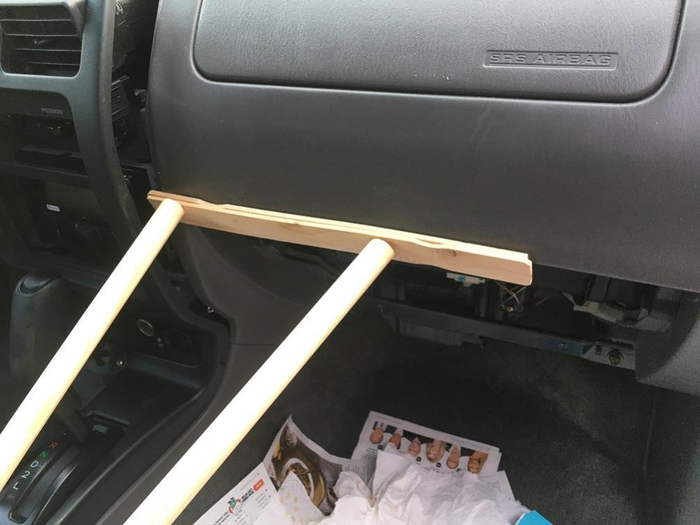

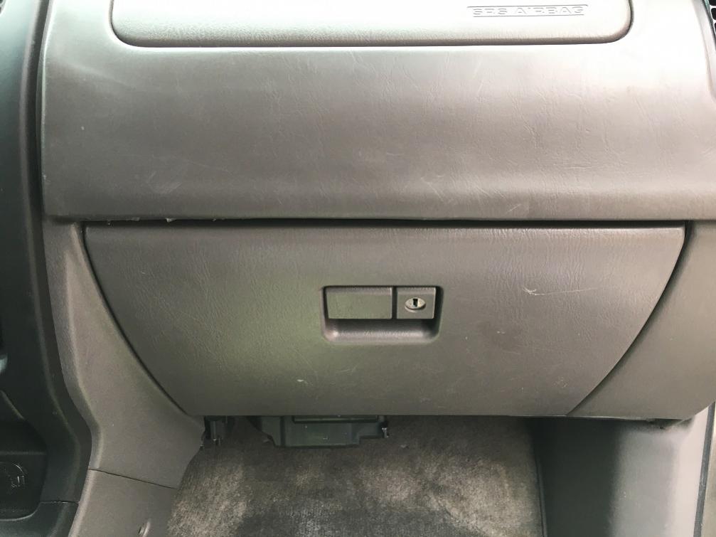

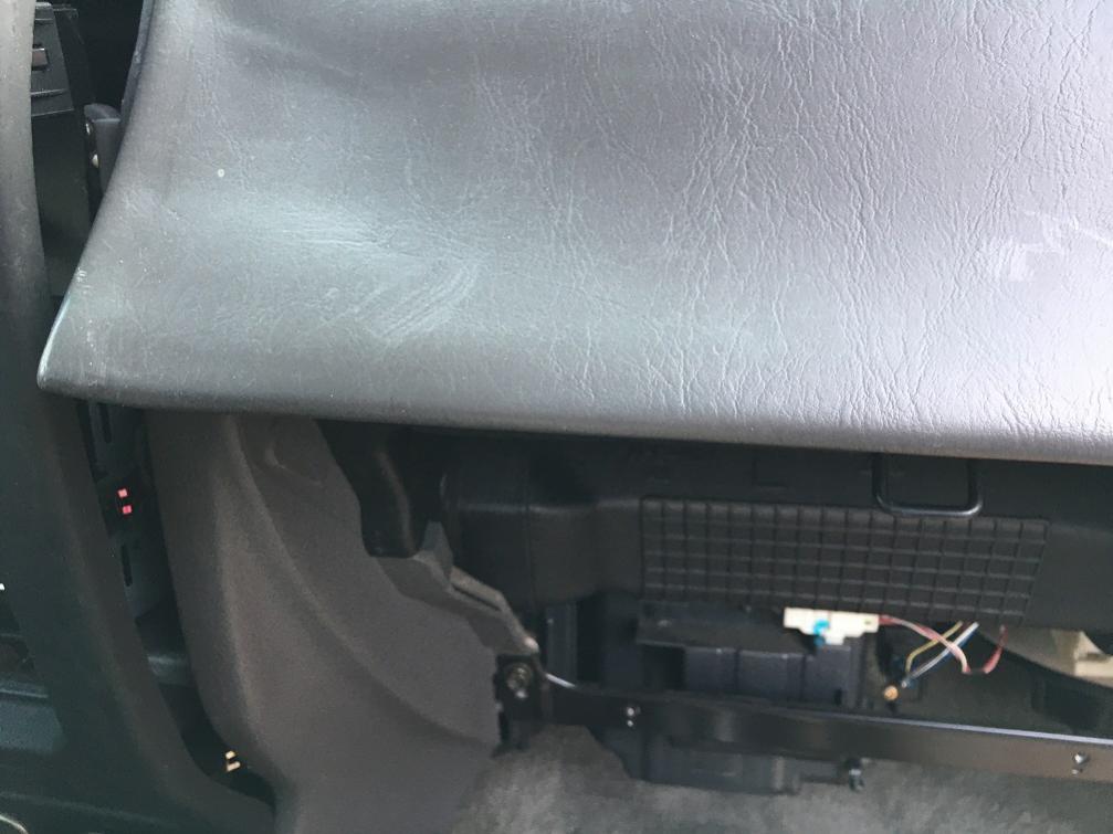

Resurecting this thread after a few years. I used E6000 on the edge of mine in 2014. I then "gave" the truck to my niecesfor a couple of years and just got it back. The dash is worse but I know understand a little more about what Toyota tried to do. here is the dash. Toyota used some very cheap metal tabs to try and hold a curved piece of foam in place. The tabs unbend the dash uncurls. The tabs actually have holes in them and all Toyota should have done is use the hole and put a clip thru it. I bought some clips and can do that on the center tab. The far left can't be accessed unless you take off parts of the airbag system from below. Not interested in that. I bought E6000 cement and two sticks to provide tension. In 2014 I tried a clamp and found it very difficult to find any area to attach the clamp. I used some dowels and paint stirrer to provide tension. I also tried some heat and quickly stopped. It seemed like the heat was hurting the dash. It seems to have worked but no idea for how long.
