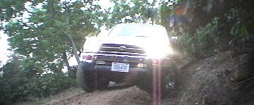

I was told by the previous owner that my 4runner SR5 has a Rear Differential Lock. Is there any way I can find out this by my self? Also, is it possible to install lock diff on the front wheels as an optional factory add on? I'm new into this offroading world and as you can see I don't have much knowledge about it? Is it possible for anyone to give me a brief introduction to locking differentials and gear ratios?
