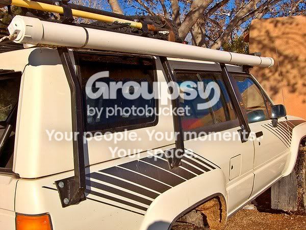

Like this
BUT the legs would mount directly on the metal panel, not on the caP.
I actually like it myself, IF I had room to store my caP when I go topless.
Image Copyright belongs to Yotatech member A7mgte.

Here's one way.
I think personally I would not trust the sheet metal unless I put some reinforcement inside the quarterpanels. I'd rather use metal resting on the bed rails like a pickup ladder rack.

Interesting, but I'm not seeing the specific picture, there are like a million on that thread haha. But from what I'm gathering you mount your rack to the metal sheeting, and mount your sheeting to ???
i've been playing with this idea also. I don't like the idea of bolting to the bed rails. Was tinking of going all the way down to the bumper (in my case, tied to the frame) for the rear support. Options are limited for the front supports, maybe utilizing the cab gutters. Build a sturdy frame and then maybe an aftermarket roof rack to bolt / weld to my custom frame.
Here's one way.
like you I wouldn't trust the sheet metal to hold the load like that..
plus too many dang holes
you could sandwich the mount between the bed rail and top to place the load on the bed rail, a thin enough gauge steel would not interfere with the seal much
