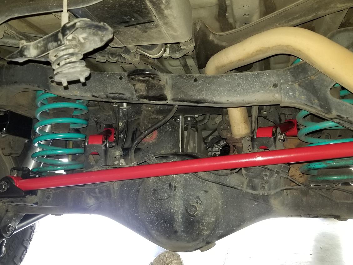

I pieced my long travel together. I did MT Radflo 2.5" long travel shocks, valved slightly softer though. Dobsons 577v long travel springs, MT bump stops, MT lower links. I choose ReszFab upper link because they offset it, as where MT does not. I read a few things about upper links hitting the gas tank at full flex. The ReszFab ones do not. I also got a ReszFab panhard bar, but that's only because they gave me a killer deal on it, it's not necessarily needed. I dont recall what brake lines I got, I think they are Wheelers from a black Friday deal.
All works well. Rides awesome. I have not fully flexed it yet, but have not bottomed it out from what I have done yet.
You wont get any more flex from just springs. The shocks limit your travel. Without different shocks you can change the ride all you want, but without shocks you wont change your travel.
Talk to Josh at Apex Overland. Great guy/vendor to deal with. I got everything except my ReszFab stuff from him.

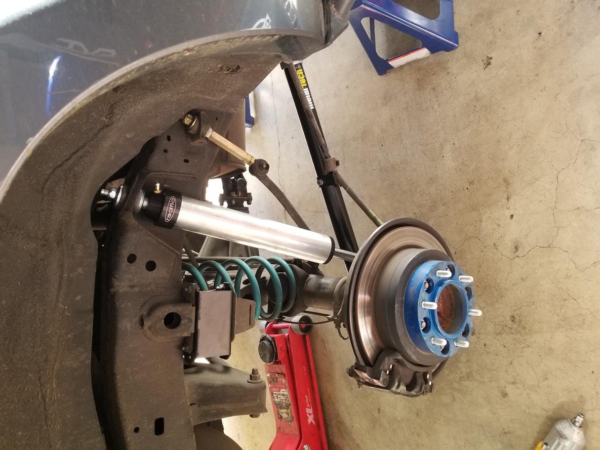

Yes, 'LT' coils will work just fine with a standard shock. I have no extensions, just coils, standard length Icon shocks, removed sway bar. Keep in mind I have a 1.5" body lift which will make my flex look larger, but 35" tires which makes it look smaller compared to say a 33".
If you're going to buy upper/lower links anyway and potentially remove your rear sway bar, MT LT is a great option. But you can basically bolt on the standard length shocks and get good travel from them as well. I don't think my rear tires see air too much and if they do it's because I'm dinking around on an RTI ramp or took a bad line on a weird obstacle.
Tire is just off the ground in this first picture but completely tucked on the other side and probably on the stock bump stop.
