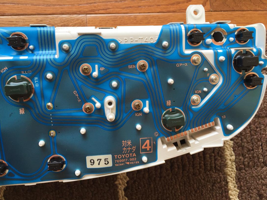

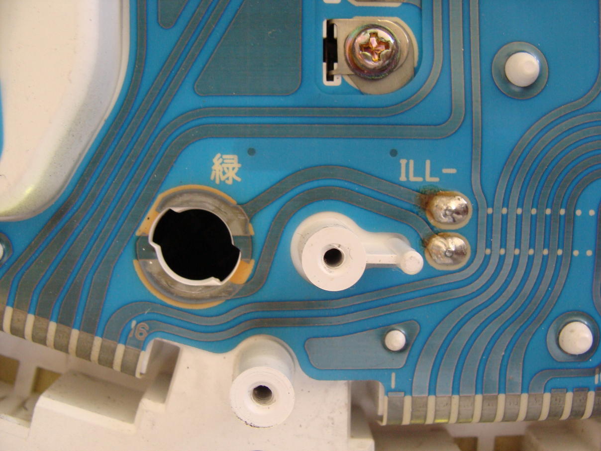

I finally figured out the solution to this problem thanks to smallfry and some other research. The problem is the blue flexible circuit board on the back of the instrument cluster unit. The board was corroded and shorting things out causing all sorts of weird problems. I tested some of the circuits on the board with my multi-meter, but was never able to confirm a short. I found some other blogs where guys had very similar problems and said replacing the board fixed it. For about $50 I figured it was worth a shot.
I have a 2000 4Runner SR5 (not Limited) automatic 6 cylinder (5VZ-FE engine) with 197K miles. The CIRCUIT BOARD part is 83861-3D260 for $51.36 online. I was getting a P1780 code that pointed to the park neutral switch, but that was fine (the Toyota tech tested it). Here are more of the symptoms I was seeing:
- Check engine light was on. Getting P1780 code.
- The reverse “R” indicator light was dimly lit when the headlights were off and the truck was not in reverse.
- The “R” would brighten some when the headlights were on and it was not in reverse.
- When driving and the high-beams were switched on, the truck would rev higher and seemingly lose power. What was actually happening was the truck was shifting down into first gear (really weird, but the Toyota tech confirmed it).
Other people have also reported other strange things with the instrument panel lights. One other thing is that this is an easy job. Removing the instrument panel is pretty simple and fast. Just remove the bottom panel below the steering wheel (4 10mm bolts), pop off the small plate that surrounds the key hole, remove the instrument panel cover (4 screws). I popped off the dash light dimmer knob and the little alarm unit so I could remove the instrument panel cover and clean it up. Then there are 2 screws that hold in the instrument panel. Remove those and unplug the wires on the back. That’s it.

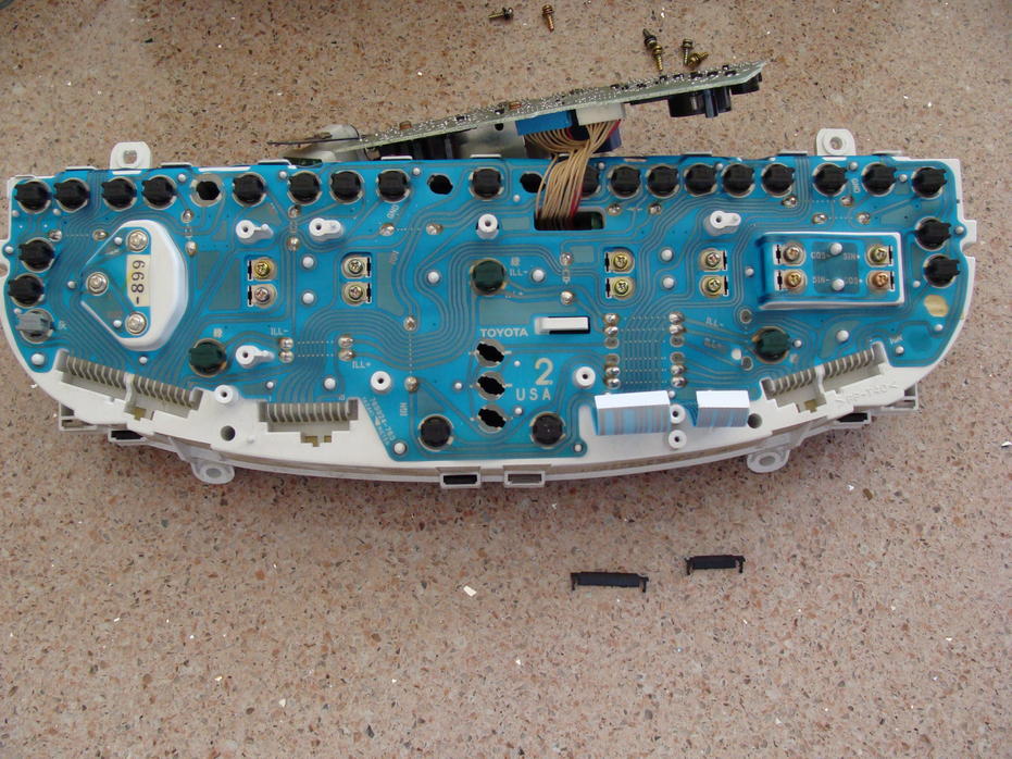

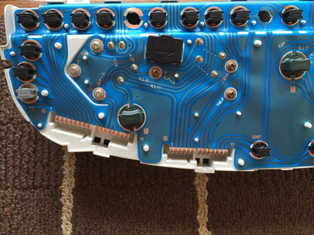

Ok, I was having this weird shifting all of a sudden and couldn't figure out how it was happening. I just realized what was making it happen! If I put my left turn signal on or right turn signal on, that's what causes it to upshift and get confused with the gears! but only when I put the turn signals on... I have a '97 limited. I just pulled out my gauge cluster and will attach pics. BUt how do I know if it's that board that's bad? Another thing, if I drive without the gauge cluster OUT for a short drive and put my signal on and it doesn't do the crazy shifting, then we know it's that board 100%? The signal makes it do it every time normally.

Wow, what a crazy one!
Based on your tests, it is definitely something with the gauge cluster. Check all those traces really carefully...
Especially the wires from the section of the cluster with the gear indicators and the turn signal bulbs (anywhere those traces get close to each other).
Good luck!
You probably can get a replacement cluster and just swap in your speedo/odometer...
-Charlie

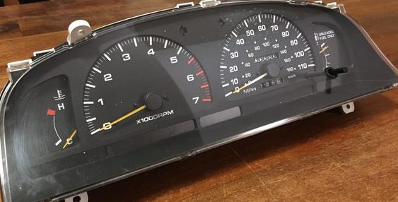

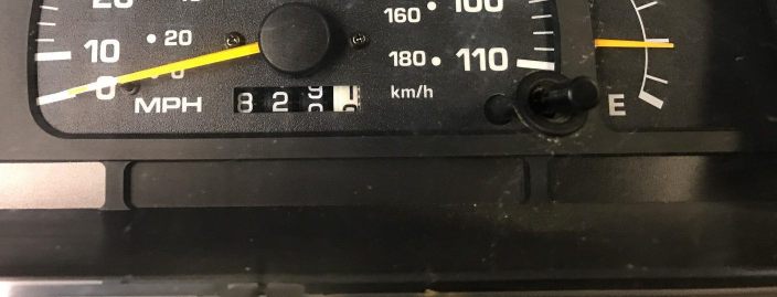

Since i have a '97, I don't have any of those gear indicators. Those were only added on 98+ models....

Nope, I do not... only 96-97 are this way, then 98+ I think added those indicators on left... Edited my posted above to show pic of other side. Then on 99+ indicators on the right side. They must have made a change for later years. BUT, 96-97, NO indicators anywhere except on shifter console.
