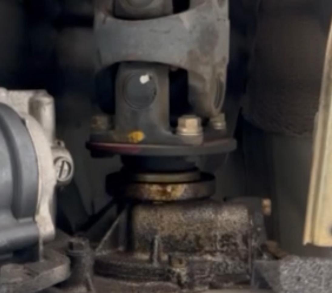

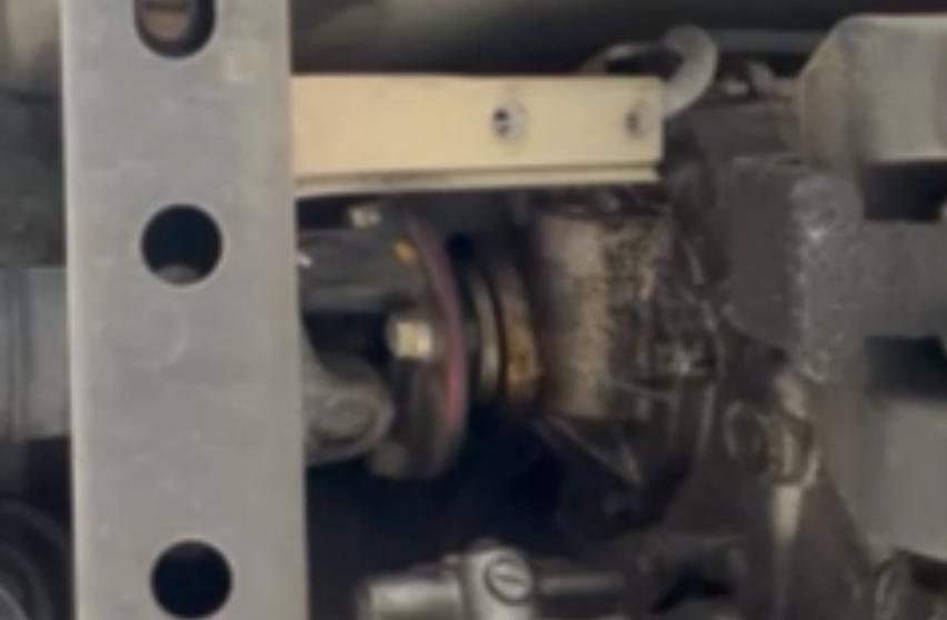

Thanks. Is this it?
First photo: Left to right = rear to front
2nd photo: Top to bottom = rear to front

That’s the rear output seal for the transfer case. As long as it hasn’t slung gear oil onto the body then it’s not leaking that bad to be an immediate problem. I would check your transfer case fluid level though.
