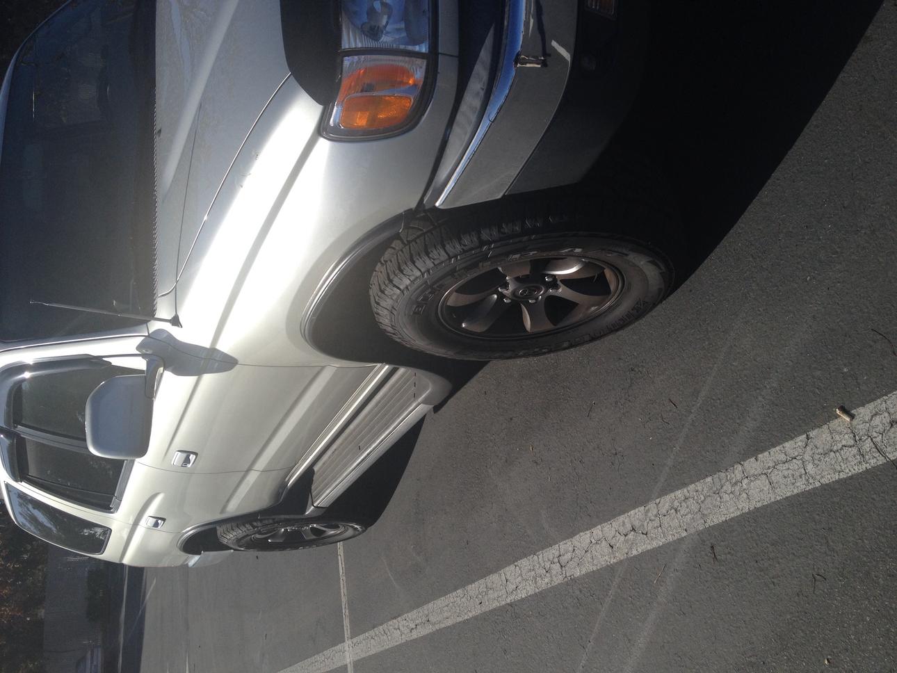

What do you guys think. 1" spacers or leave it?
I'd say no and ditch the running boards.
My truck came almost identical, I even took off the plastic fender trim. Looks pretty good that way...at least to me.
Just to widen the stance. Tires slightly rub on full lock. But not to concern me.
I'm not sure if it even looks better. Just an inch. No more than that. And 1.25 in rears to even it out.
I'm running Spidertrax 1.25" hub centric spacers. I have had zero issues with them. Locktite them to the stock studs and torque to 90 ft/lbs. Then, once in a while pull the wheels and check their torque at 83 ft/lbs (factory spec). This way your torque wrench will confirm their torque is above 83 ft/lbs without breaking the loctite.
I like having them since I'm lifted, it's nice to have a wider stance plus it looks better.
I did not know that was the reason for a narrower stance in rear. When u say track better. What does that mean. On freeways?
Going down the road, it tends to stay straighter with less wandering.
Also, putting 1" spacers on the front usually has an issue. The stock studs are usually longer than an inch so most people cut a little off the studs. I'm not a fan of this due to the heat created while cutting. This heat can reduce the heat treating of the studs.
I would for sure pull off the plastic trim around the wheel wells looks much cleaner! Pulling off the SR5 running boards gives a tougher look. I would only keep them on if you plan on lifting. I'd do the spidertracks 1.25. One inch isn't worth it.
