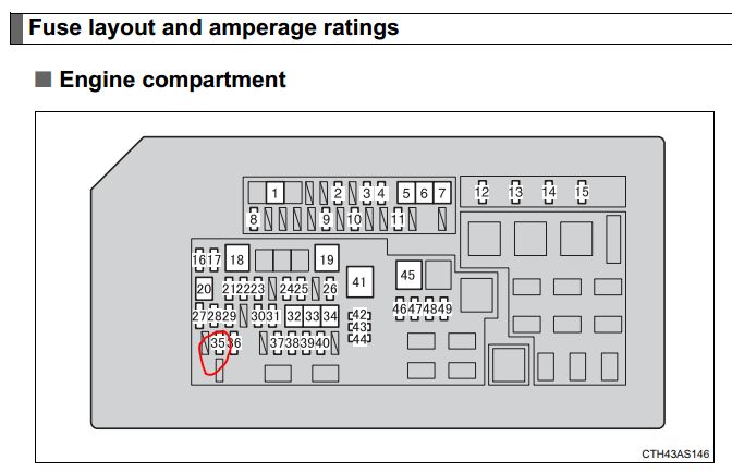

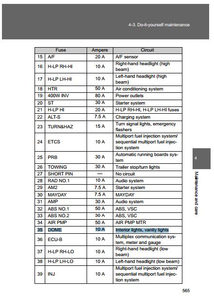

What fuse(s) did you replace?
Also did you do anything other than try and install the LEDs?
Pics attached to show which fuse.
Also - I installed the LEDs months ago and everything was fine until today, when I replaced just the dome light. Didn't do anything else on the car.
