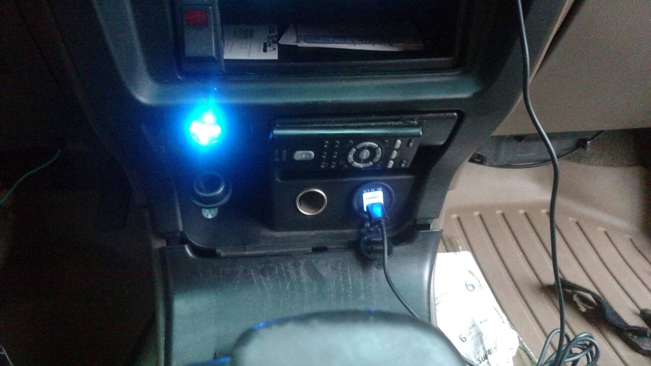

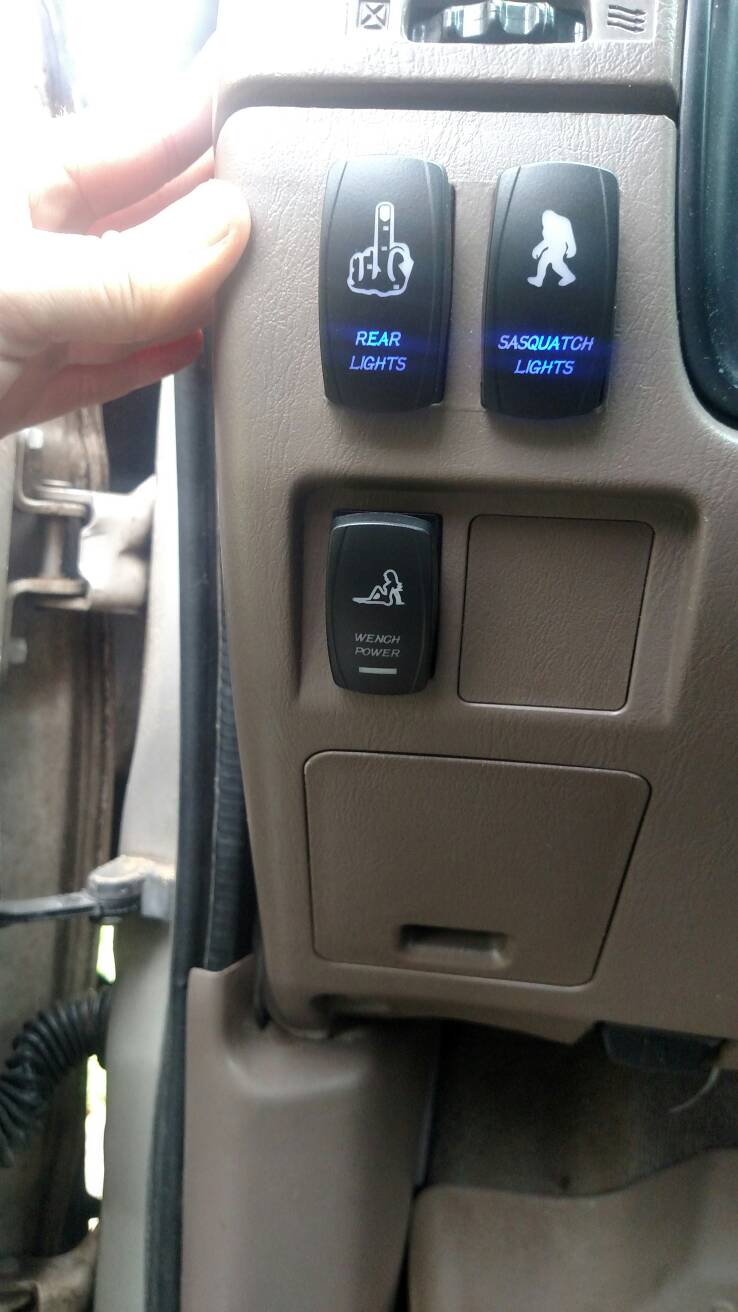

I got some LED reverse lights, a curved 42" light bar, and a panel that has LED rocker switches and marine grade 12v outlets from my girlfriend's parents for Christmas. I've had the switches and reverse lights installed for a while, but forgot to post a pic. Did the outlets today. Switches and dual usb outlet are tied into the box with add a fuses, so they get power with key on only. The last outlet is constant hot, for days i need to leave my phone charging in the truck for a bit. Cut the plug on my radar detector and soldered a usb on it, so that it could be powered by one of the dual usb outlets. [ATTACH][/ATTACH]
