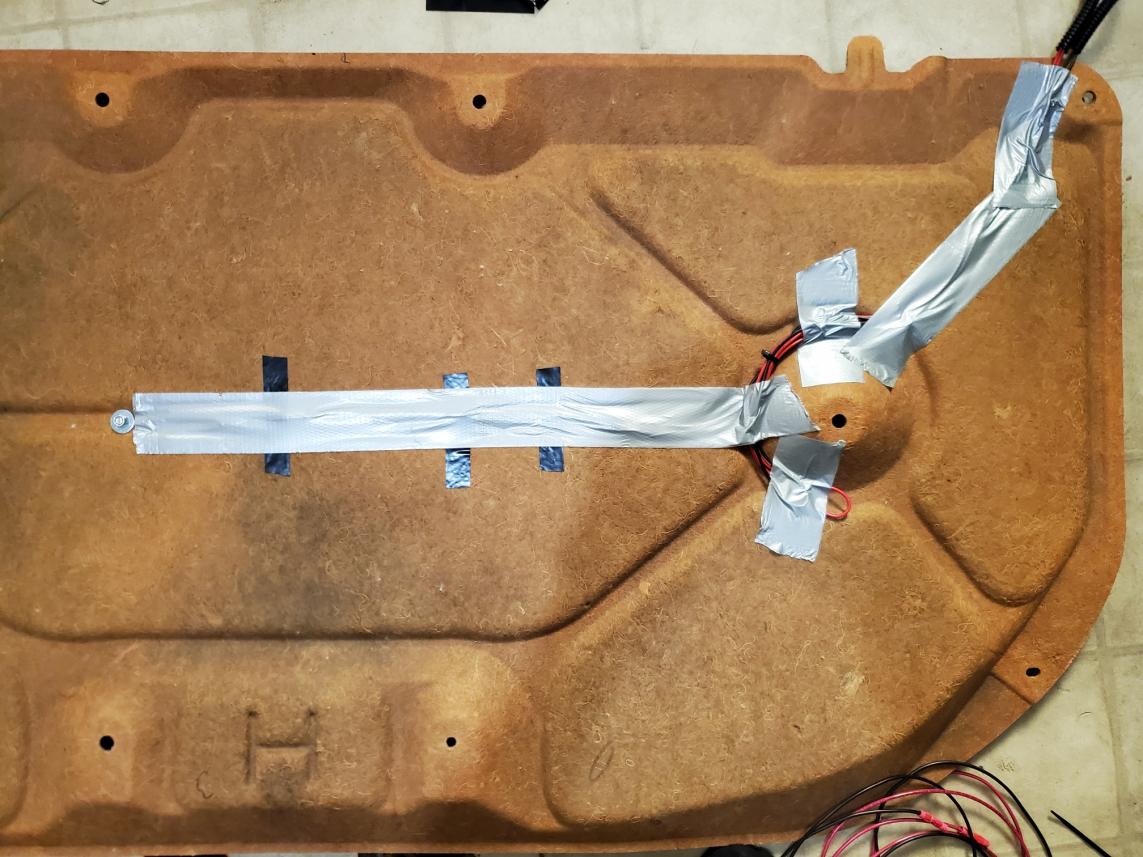

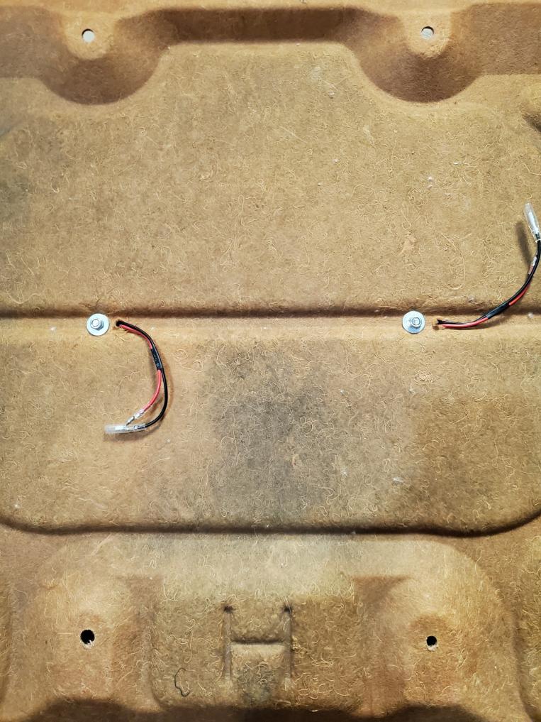

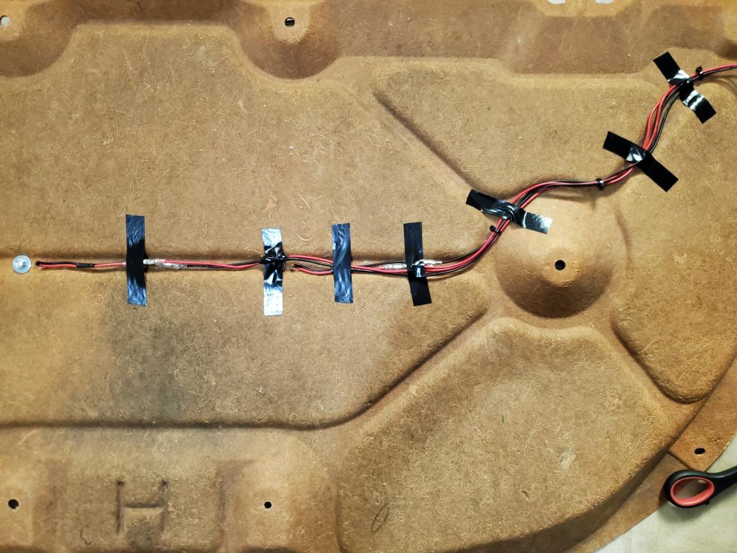

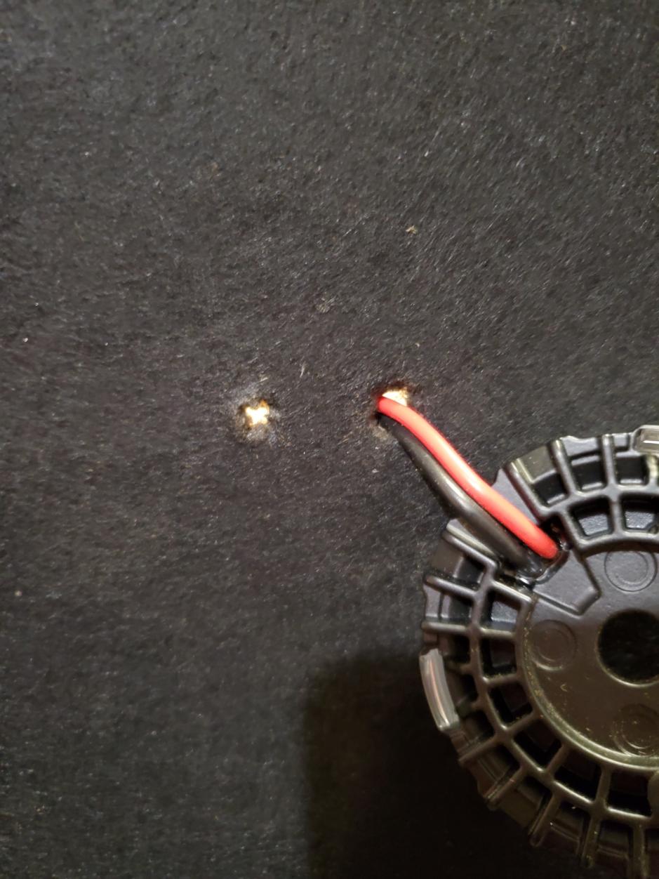

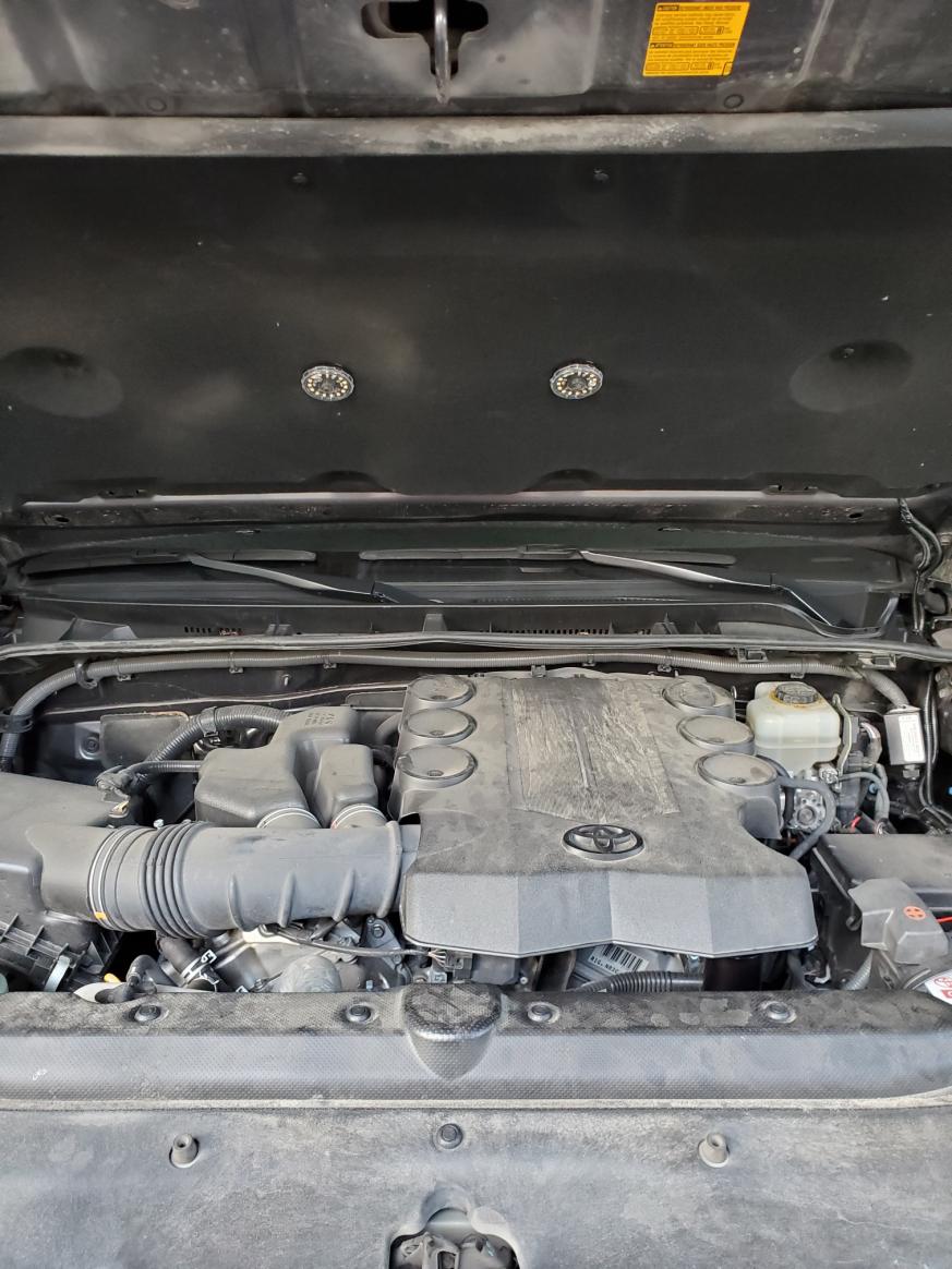

Attached mine to the insulator because I didn't want to drill any holes. As you can see there are grooves in the back deep enough for a nut and washer. Does not make contact with the metal. Great place to run the wires as well.
