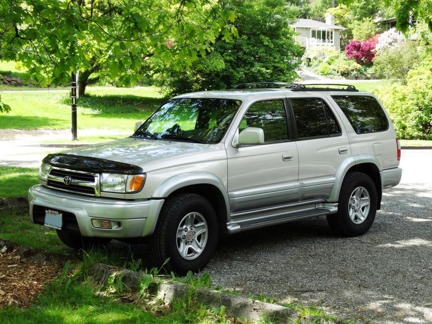

This picture is of our 2000 4runner Limited right after we bought it in 2013 with 148000 miles on her.
Here is what she looks like today. (Finally got around to getting the running boards removed).

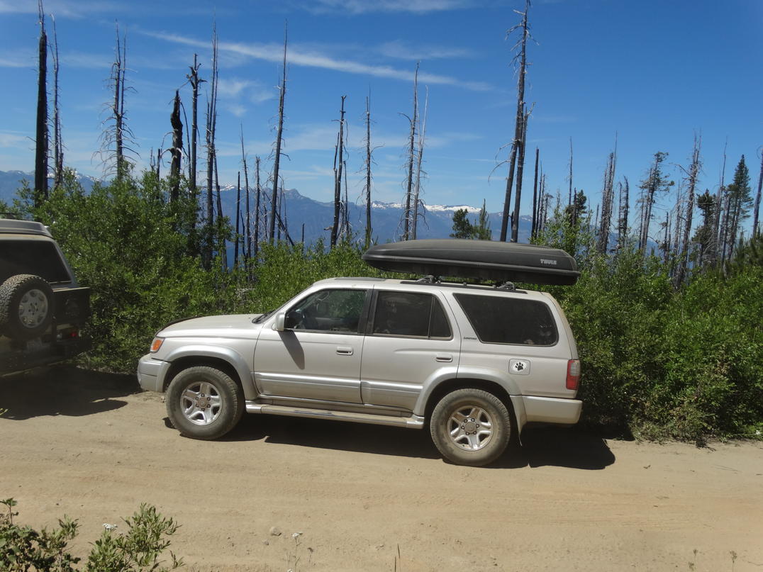

Our rig during one of the rides at the NW Overland Rally 2015 in Plain, WA. Boy did we get some ideas on that trip!

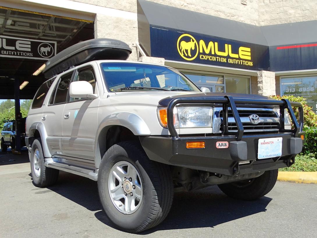

Our first major modification after the Rally was to get an ARB front bull bar installed, and to replace the worn suspension system with Old Man Emu 881s and 906s with matching Nitrocharger Sport Shocks.
Thanks to Mule Expedition Outfitters located in Issaquah for the great advice and installation.
Starting to look good!

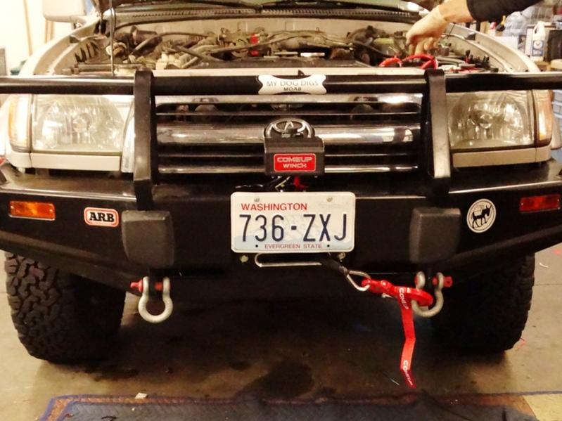

Now, here is where it got tricky. I told him of our future winch plans. The winch I wanted is the Comeup SealGen2 9.5rs winch, which is larger than the Warn winches that fit in the ARB bumper. The mechanic was concerned about putting the transmission oil cooler in front of the condenser, because of the room the winch would take up. So, he ordered a large (10" H x 15 7/8 L") Hayden high performance transmission oil cooler, moved the radiator back just slightly, and sandwiched the transmission oil cooler between the condenser and radiator. This saved room for the ComeUp winch in the front. I posted about this, and got conflicting opinions on the intelligence of this move, but in the end I am glad I did it. The general consensus from many on this site, other mechanics and the folks I talked to at Hayden is that while the cooler won't operate at peak efficiency, it will still improve temps over the stock set up, and there is no chance of ending up with a ruined tranny due to the pink milkshake issue.
Next up, installation of the dual battery system and the winch. Both installed by the awesome folks at Mule Expedition Outfitters.

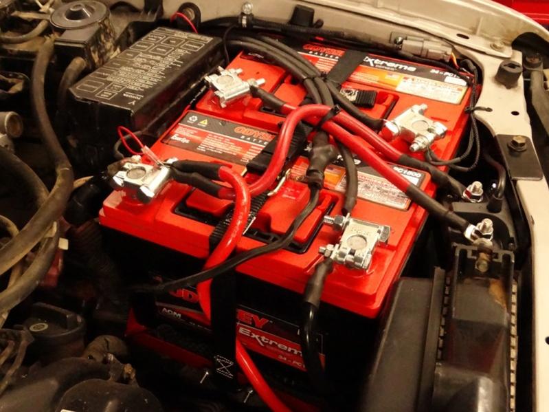

Dual battery system....Custom battery tray made by Mule Expedition Outfitters. 2 brand new Odyssey Deep Cycle Dual Purpose Batteries. Blue Sea Charging Relay System. Victron Dual Battery Monitor.
The short and sweet of it is that when I start the rig, the charging relay system charges the starting battery first, then switches to charging the auxiliary battery. When the engine is not running, the relay isolates the batteries, which means that future electronic devices running off the auxiliary battery will not run the starting battery down. I can monitor all sorts of data about both batteries with the battery monitor, mounted underneath the radio. This system was installed, because we will be purchasing an ARB refrigerator and lighting soon, which we can run without worry when we camp. We will soon be also purchasing a 90 watt solar power system. Recharging electronics, running lights and the refrigerator will be no problem.

Just got some new toys in her, and want to show them off!
Installed a transmission cooler, no more pink milkshake concerns.
Mule Expedition Outfitters, my "go to" shop for upgrades I can't or don't want to do, installed the dual battery system with relay and battery monitor, and the winch.
Here is the list of goodies....
Dual Battery System
Blue Sea automatic charging relay system for the two batteries.
2 Odyssey Extreme dual purpose deep cycle batteries (PC1500DT)
Custom built dual battery tray
Winch - Comeup SealGen2 9.5rs (12V, 9,500 lb. capacity, synthetic line, remote.
