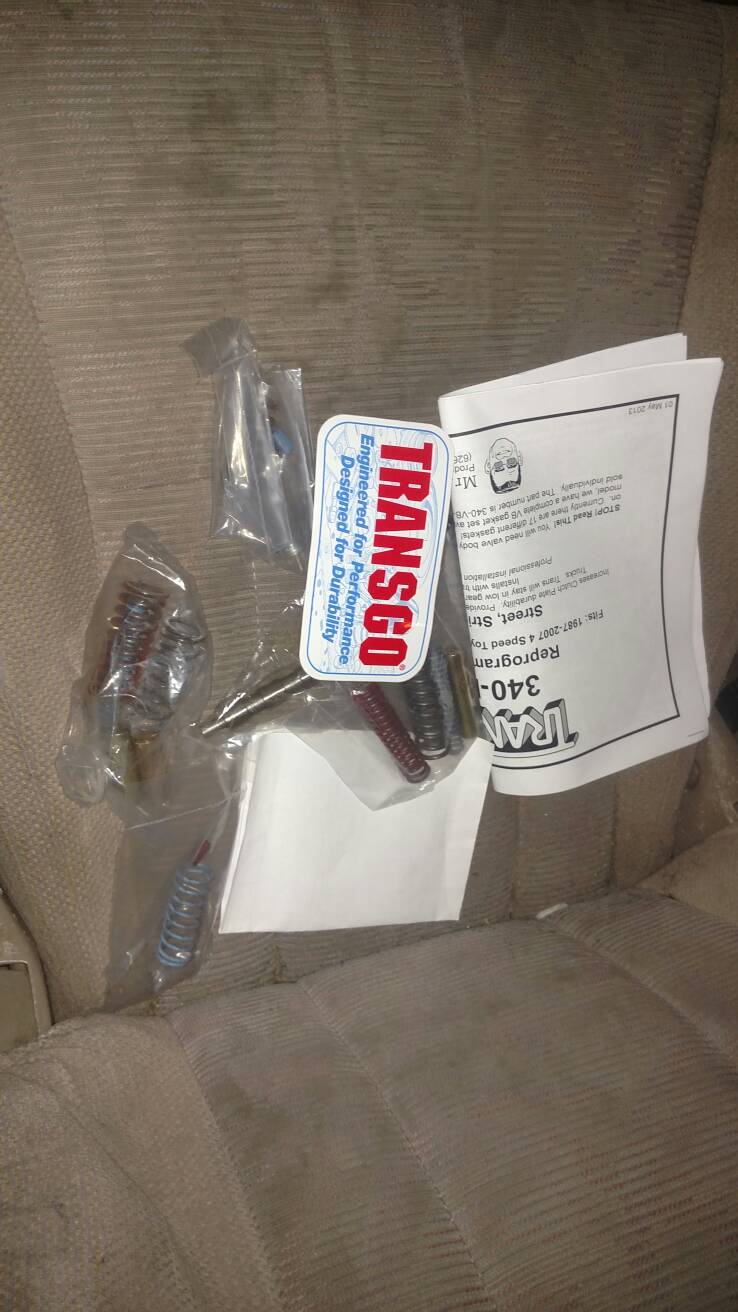

UPS guy dropped off some goodies! Build thread Build thread-uploadfromtaptalk1464758754311-jpg

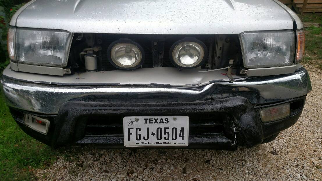

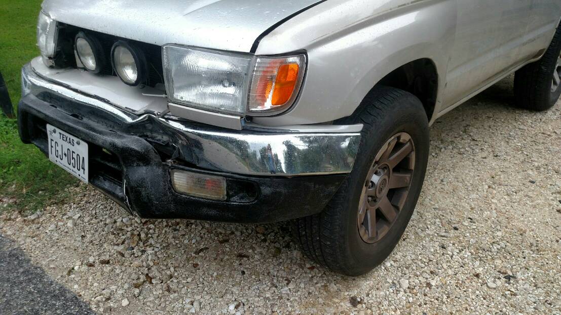

Update time! So, no 4wd swap progress yet. I ended up in a fender bender and had to take time and money to repair the damage before anything else.
Build thread: http://www.toyota-4runner.org/showthread.php?t=219718

Luckily, no serious mechanical damage! Front clip was pushed in a little where the headlights mount, pulled it out and got it pretty straight. Replacement fender, replacement grill. Plastic welded the headlight buckets where the mount tabs broke off, and put new bulbs in while i was at it. Pulled the old bumper off, and decided since I now NEED a new bumper I might as well save a little and drop some cash on a tube bumper (coming soon). Since my turn signals needed to be replaced and I would be going with a different bumper I decided to make some custom LED signals to go in the headlight filler panel. My girlfriend was kind enough to make templates for me to follow for LED placement.

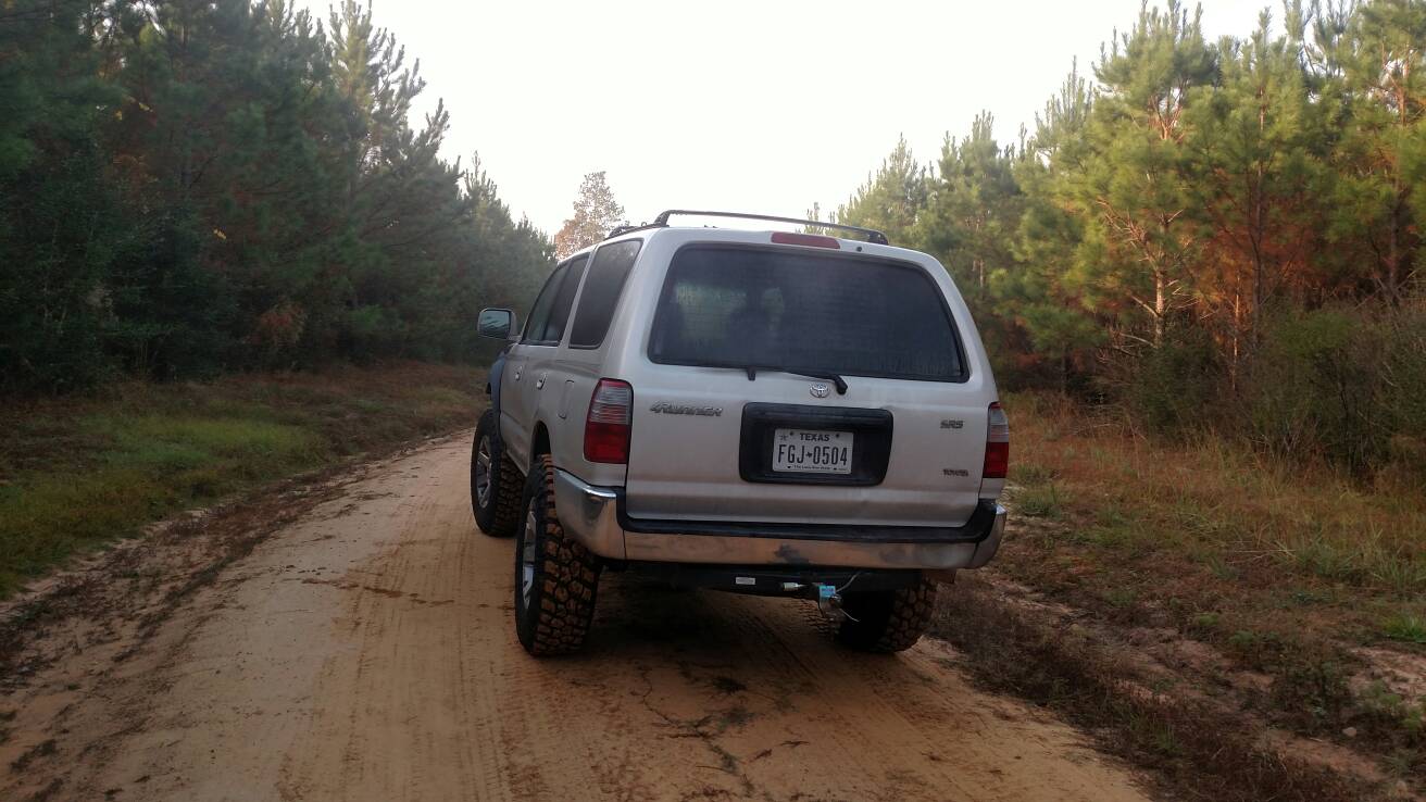

After that i decided it was time to replace the nearly bald 265/70/17 duelers that came on my trail edition wheels. Went with some 255/80/17 BFG KM2's. I went with a tall skinny tire to avoid rubbing the UCA and to not suffer power loss before regear. So far I'm really impressed with them. For the first 400 or so miles they felt like they rolled/bounced a little more than i liked, but now that they've broken in a little they feel very sure footed. They're quiet (we'll see how loud they get when they wear a little through) and ride good on the highway.
