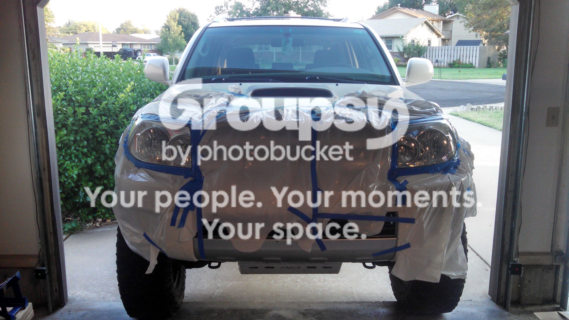

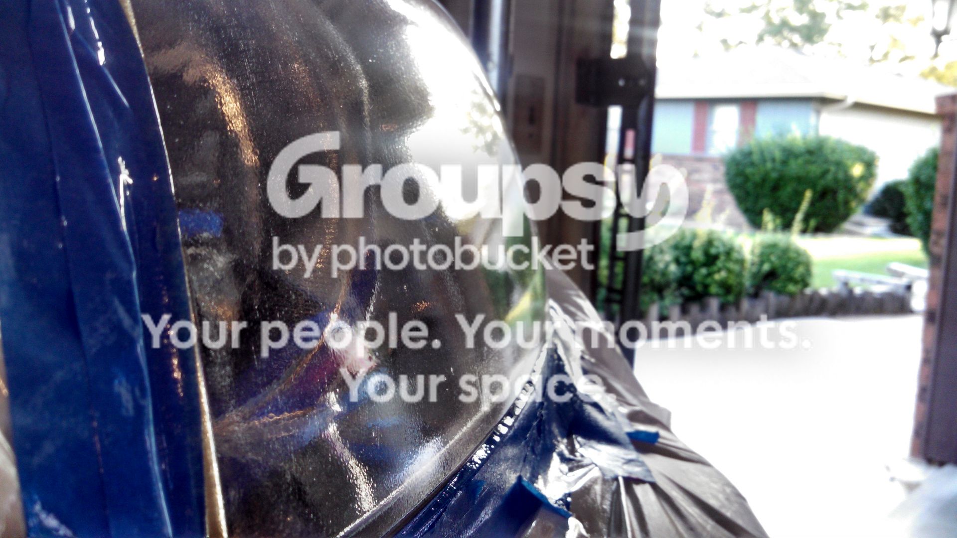

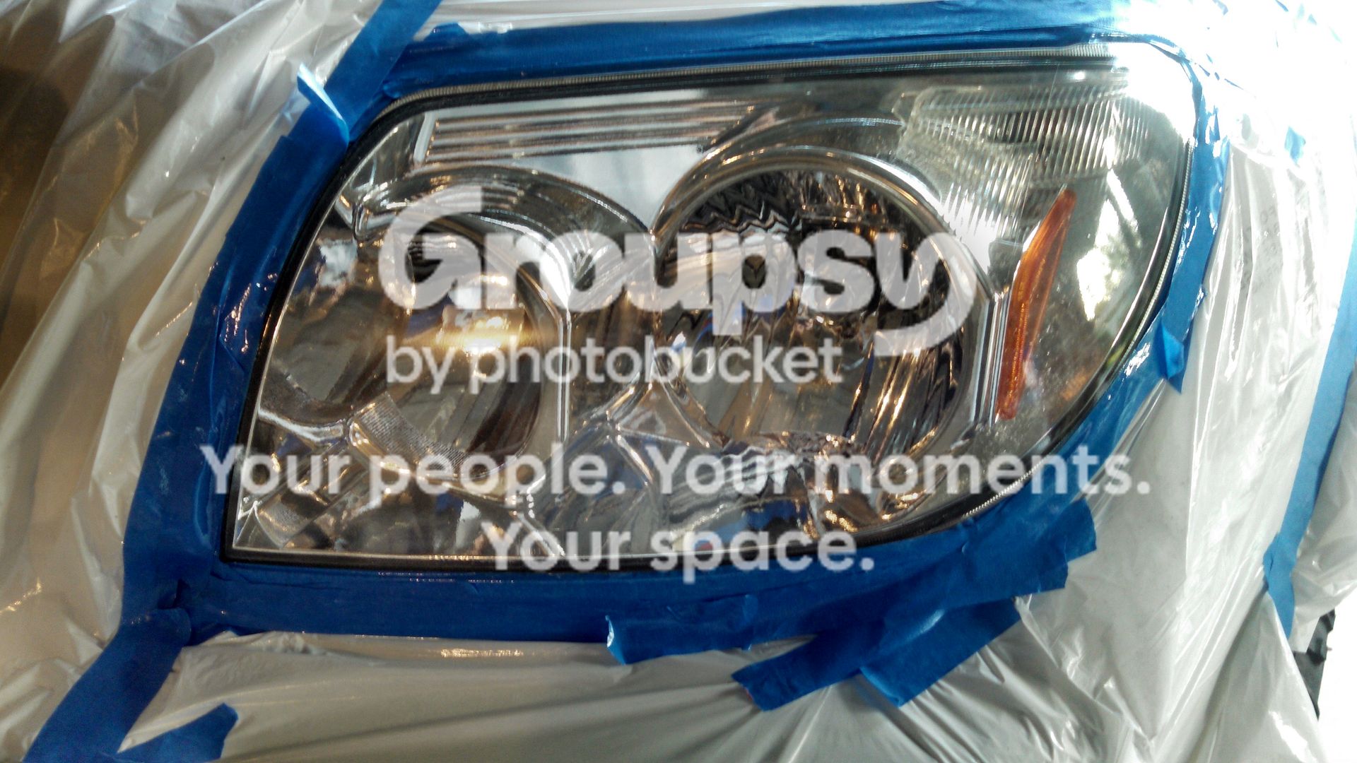

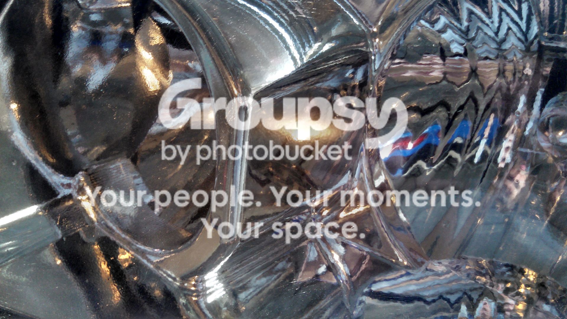

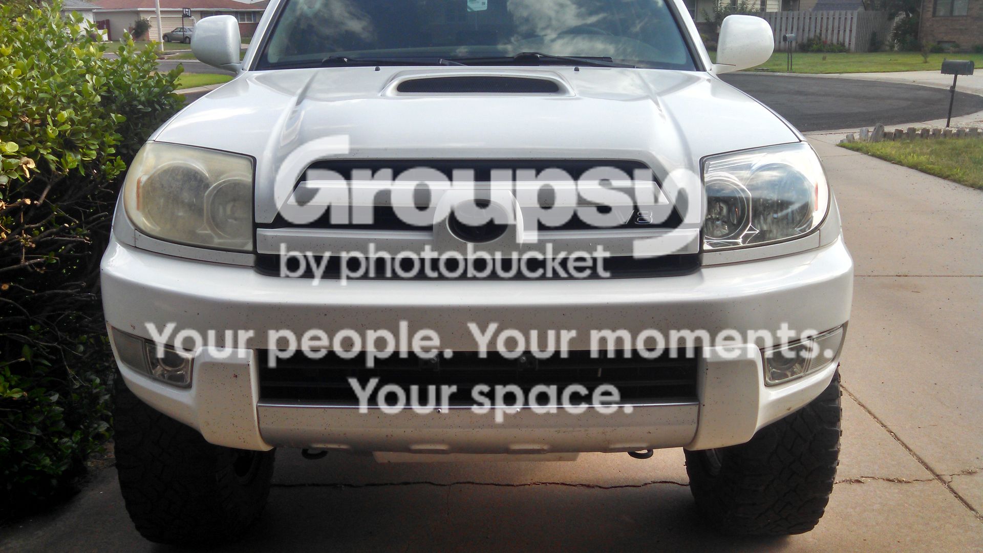

I finally got around to clear-coating my headlights from the suggestions in this thread. Thanks for those suggestions! Here is a quote from my build thread:
Decided I would tackle re-buffing my headlights. It's been almost a year since I last buffed them and they been looking pretty bad for a while now. This time I buffed them with my DA polisher like last time, but I sprayed an automotive clear coat (2k) over top afterward. Hopefully they will last longer with the clear coat. Lots of orange peel which I'll try buffing out once it fully dries. I obviously still have a bunch of the cracks in my old headlights but at least they are not too noticeable when they are clear.
Left side buffed:
Right Before spraying with clear:
After clear coating/ still drying:

Before and after:
