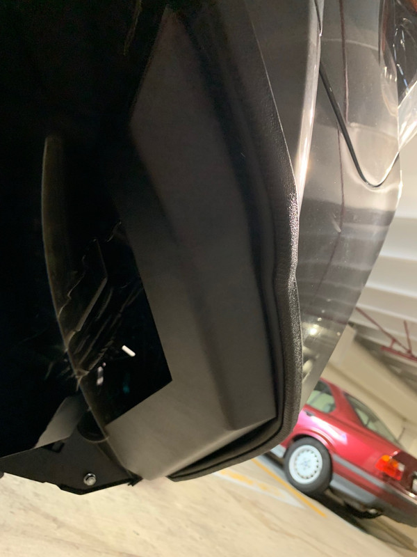

Why aren't people just trimming their bumpers for the same amount of clearance? These winglets have zero weight bearing capabilities so they offer no additional protection.
Thank you! I started a theead on this with little input from other forum members. All you need is a dremel and some $10 rubber door stripping from Amazon. The SSO for $330 says it offers you way more protection? What a joke...people are so quick to spend hard earned money hand over fist, instead of doing their own fabrication work.

^Every time I see the bumper cuts I want to go out to my driveway with the dremel and do it.
What did you do with the fender liner? Also, I would guess the mpg staying the same? Unless going like 80mph I wouldn't think the aerodynamic would really matter that much.
Just trim the liner along the same level where your fender cut finishes. I rattle canned the washer fluid tank as well so it doesn’t stand out. No issues with mpg!
This looks great, I like the less extreme angle of the cut. Can you post a pic of the entire front view if you get a chance? I'd like to see how it compares overall.
