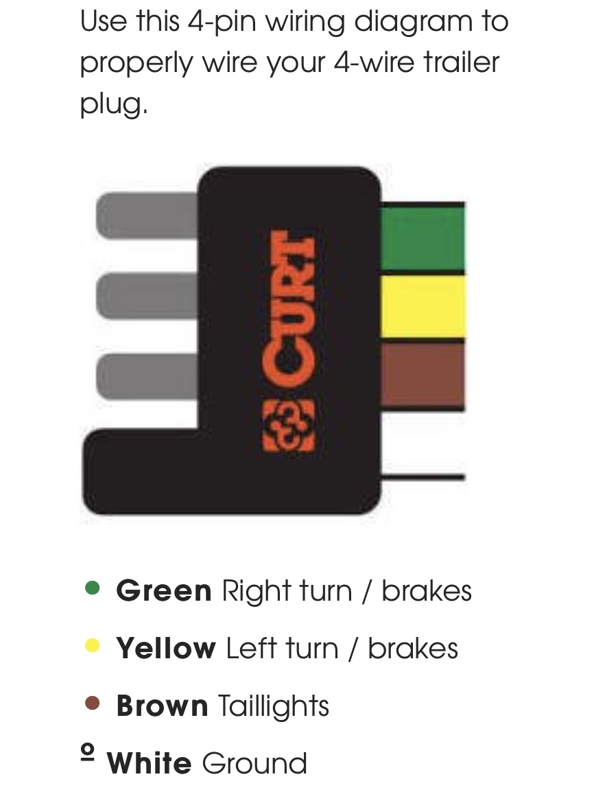

As @fkheath said you can plug into the 4-pin trailer socket with a cable to break out the GND and Taillights wires to your license plate light wires, or splice into the actual wiring as described on the other forum,
License Plate LED Light Addition for Hitch Mounted Tire Carrier | Toyota 4Runner Forum [4Runners.com]
Make sure you test the taillight to determine which is the +12 lead and the GND lead.
