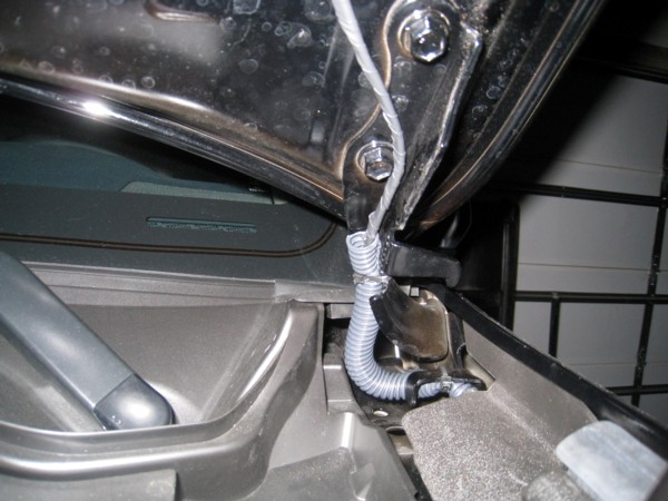

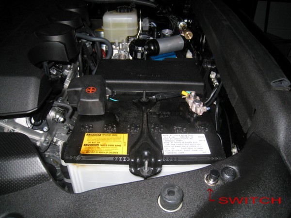

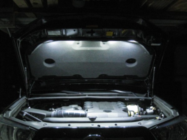

LEDs installed in engine compartment
Installed Oznium.com LEDs in the engine compartment today. They look awesome! Can't believe the 2010 t4r didn't come with a light under there. Anyways, I ran a wire up the right hood support arm, and then up to the area just aft of the the hood latch. This part actually faces inward and down, so it is a perfect place to put some lights and not have them blind you and also be out of the way. I also put in a switch in the front. Right now it is just a toggle, and it is not high enough to be pushed in and out by the hood, BUT I plan on changing that...this switch is all I had at the time. The one Oznium sent for this was a total piece of junk. Pics are not that good sorry!

That is one of the coolest mods I have seen on this forum. Awesome!

engine compartment LED lights under the hood
Quote:
Originally Posted by Titanpat57 View Post
Very nice!!!
Would you mind putting up a link for the LED's?
Thanks, and great job
Here ya go:
Tiny LED Modules : High brightness surface LEDs
I would caution that these are really small...so look at the exact measurements before you buy. I thought that they were gonna be a little bigger because I didn't look at the fine print...I still think they are great, but I had to use four of them instead of two, which actually turned out looking really awesome!
What I put in my hood is TWO of the round ones on the outer edges, and then TWO of the long ones for the middle ones. I got the white ones with black housing. All four of them put out the same amount of light roughly...if I had to say which one puts out more light, and it is really close, I would say it is the long ones...both have 6 HP LEDs in them...
Also, I bought this switch, but it is a piece of crap.
Adjustable Door / Hood Pin Switch
It is made for a pre-tapped 5/16th hole, which I didn't realize til after I got it. Tried to retrofit it with a nut and a washer, and the threads are just not long enough to mount it like a regular switch. I am headed to Radioshack to see what they have, or maybe auto parts store...in the meantime I mounted a toggle switch and mounted it lower than where the hood comes down. I just turn it on and off with my finger when I need it. Once I get the right switch, I will raise its position so that the hood engages it when closed.
More on the switch: The location of this switch that I mounted is right next to the rubber stopper, and it is flat under the hood right there, which should make for good contact with the right switch. This did involve me drilling a hole in the panel there, but only in the plastic, not in the metal underneath...there was already a hole there! It is very tight underneath it, and it might involve removing this switch to access the light housing but I AM NOT SURE...didn't try!
Thanks for comment!

Quote:
Originally Posted by Scuba6 View Post
Snoop - Great mod, and definitely on my "to do" list.
Any recommendations now that it's been up for a while? Is the adhesive on the LEDs holding tight a few months in? Which fuse did you tap (I'm sure there's a constant on in the hood fusebox)?
I think I'll go with a toggle switch instead of the pressure switch...seems easier for us novices!
Thanks again!
Thanks! I actually didn't tap any fuses, but I need to do that. I ran the thing right off the battery. My plan is to just put a little in-line fuse in there somewhere...just haven't done it yet. They have not come unstuck yet, but I figure they will at some point, but it is just not that hard to reaffix them, so I am not worried. They were originally stuck onto the painted metal finish, so it was a solid place to stick them (versus on textured plastic, or fabric).
The mod is really nice to have at night. The light that is emitted is far superior to a single bulb like most vehicles have. People who have seen it in person are usually awe struck (like they have never seen an engine compartment light before???).
Regarding the switch, I never did replace my toggle switch with a better pressure switch mainly because I have been unable to find a good one. Now that I have had the regular toggle switch, I really don't want a pressure switch any more, because rarely do you need to use these lights anyways. The location of my button is perfect and it is a snap to turn it on. Unfortunately I cannot tell you the model or type of toggle switch I used because I found it in an old parts box from decades ago.
