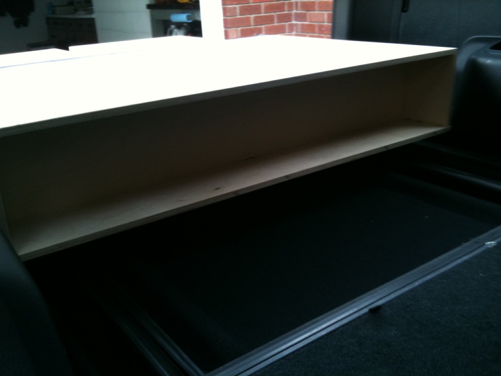

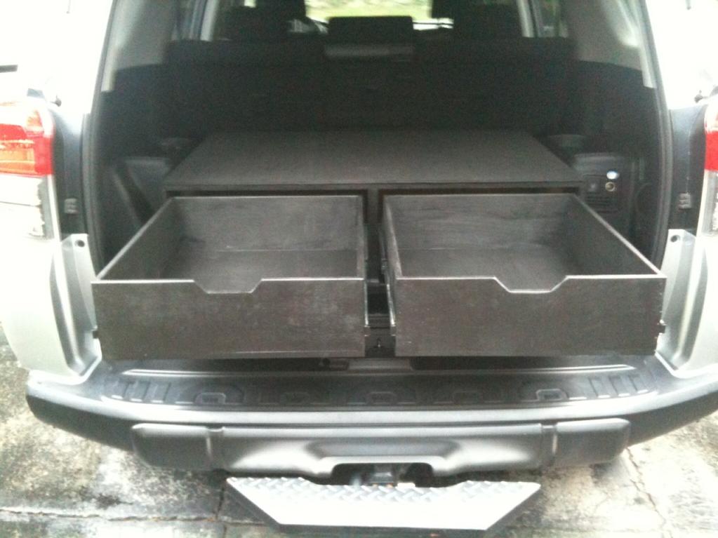

Hi all,
Latest mod is a simple drawer system that is attached with 4 bolts to the slide out tray in the TE.
It's constructed out of 9-ply baltic birch 1/2" plywood. The slides are full extention 75 lbs. a pair rated. All pcs. are glued and screwed. I contact cemented the carpet on, which I purchased at Family Dollar for 21$....matched perfect.
I also included a 6" deep pocket in front of the drawers, for either my 12guage or AK...but out of sight out of mind, it'll be a nice spot. I just haven't had the time to install the door to cover it, continuous hinge, and velcro straps.
Nothing fancy, just a hell of a lot better than the plastic foot locker I kept back there.....just got tired of digging everytime I needed something.
