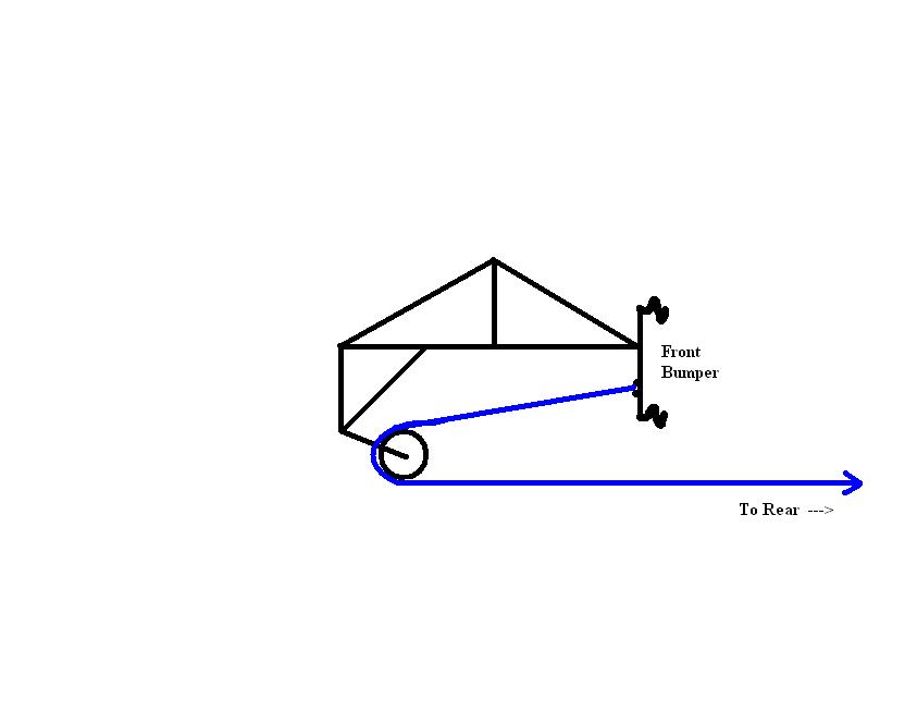

Here's an idea...
For this to work you'd need to have a receiver in the front bumper to mount the truss to. And then another fairlead in the rear bumper to feed the winch rope through to direct it out the back. You'd just use the pulley out front to change the direction of the winch rope, run it under the truck and through a fairlead in the rear bumper.
You'd probably have to build a bumper specifically for this purpose since you could have up to double the winch capacity on the pulley and that could create be a pretty large moment on the bumper.
Winch in back, rope in front-winch-truss-jpg
