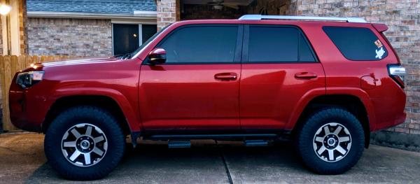

285 Nitto Ridge Grapplers, Bilstein 5100's (front set for 1.75") and 0.75" Cornfed rear spring spacers
  • Media owner MicMul
The fronts rubbed when turning while moving forward and reversing. I trimmed the front bumper, pushed the well liners forward and zip tied the mud flaps to the body mounts....still got some rubbing on the mud flaps. I ended up removing the wheel spacers when I did a brake job. The rubbing stopped and I haven't re-installed the wheel spacers.
