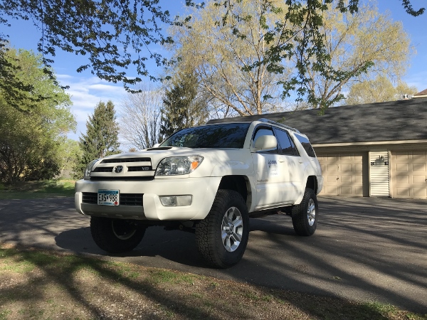

5/5/21 after: Ironman 4X4 performance lift & 255/80/17 Falken WP AT3Ws
255/80/17 fit without rubbing? I have 2.5" front and 1.5" rear lift. Currently I'm using LT265/70/17 10-pky falken wp at3. Factory wheels. Besides mud flap removal, what else do I need to do?
Well, mostly without rubbing. I get some rub on the front inner wheel well with the wheel turned (not fully-locked) in reverse, every now and then. I also have both my front and rear flaps completely removed, but I'm planning on putting the rears back on. I haven't messed with it yet, but I'd say the next thing to try would be "adjusting" the front fender liners, but I've haven't read up too much on the best way to do this. The other thing is, I don't know how different the offset is between the 4th gen 17s and my 5th gen SR5 snowflakes.
Before I did the lift, when I had my SL 265/70/17 Grabber ATX 4-plys, I would rub at full lock in both forward and reverse.
