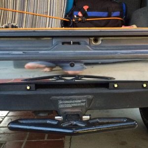

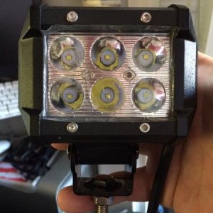

I have been playing with a lot of LED stuff lately. I have a backup camera and added 4 LED lights into the bumper to illuminate my surroundings and it makes a WORLD of difference. I also added some interior lights because the 4R is poorly lit (IMO) I used an interior switch to light up the floor area and my center console. It's bright!!!
http://www.amazon.com/gp/product/B00FEZEVQK/ref=oh_details_o06_s00_i01?ie=UTF8&psc=1
http://www.amazon.com/gp/product/B002UZZLG6/ref=oh_details_o06_s00_i00?ie=UTF8&psc=1
I have replaced all the turn indicators with LEDs and resistors too.
http://www.amazon.com/gp/product/B00HJEXEF8/ref=oh_details_o04_s00_i00?ie=UTF8&psc=1
Finally, I used Cree LED lamps to use in the fog light area to fill the holes that are intended for OEM fog lights which were not on the truck when I got it.
http://www.amazon.com/gp/product/B00G620ZVU/ref=oh_details_o07_s00_i00?ie=UTF8&psc=1
