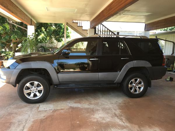

After. 2009 FJ coils and Bilstein 5100 set at .85
  • Media owner kipele
The front increased about 1.75" to 2" and the rear gained about 0.5". The ride is so much better. I guess it was time, the xreas had 123K mi on it.
FJ Springs and Bilstien 5100
