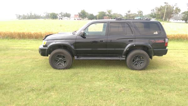

After the suspension upgrade. Swapped the front lift blocks and LC coils for Tundra TRD front coils and OME 906 rear coils, all riding on Bilstein 510
