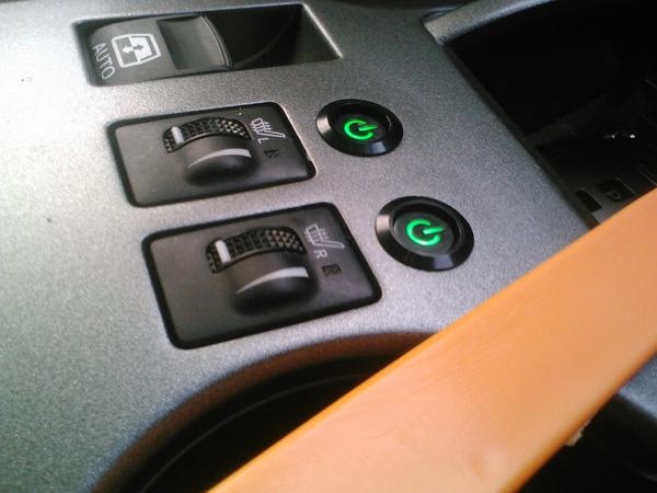

Hi Cronus,
Yeah I really like the way it turned out! There were a few problems installing the 'ON/OFF' buttons in that location e.g., the shifter "Curtain" would have interfered with the switches wiring whenever in 'Park' so I had to install an aluminum guide where the curtain comes out of the shifter at a 65 degree downward angle to direct the plastic curtain away from the two buttons. Also, the button's LED on/off indicators were super bright; actually created a glare at night so you couldn't see where you were going. For that I had to integrate a resistor in the led circuit to tone it down a bit; after that everything was fine!
