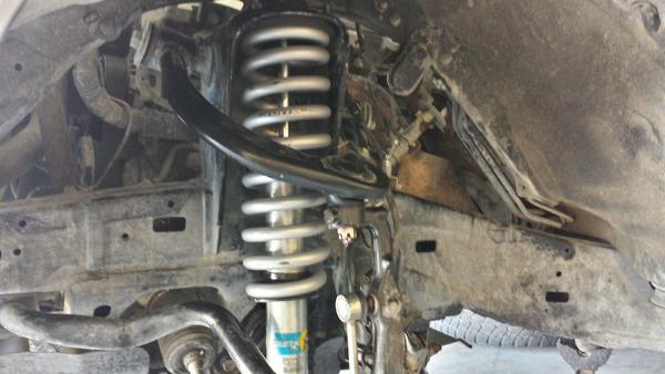

LOBO79 Sep 17, 2015 You might want to check and make sure that your sway isn't rubbing your new coils. I didn't put my sway relocator on in the front when I went to get it aligned and they rubbed a good bit.
T T Tooltime19 Sep 17, 2015 Thanks for the heads up. At the moment, nothing is rubbing,although the coils are very close to the upper arm on full droop.
