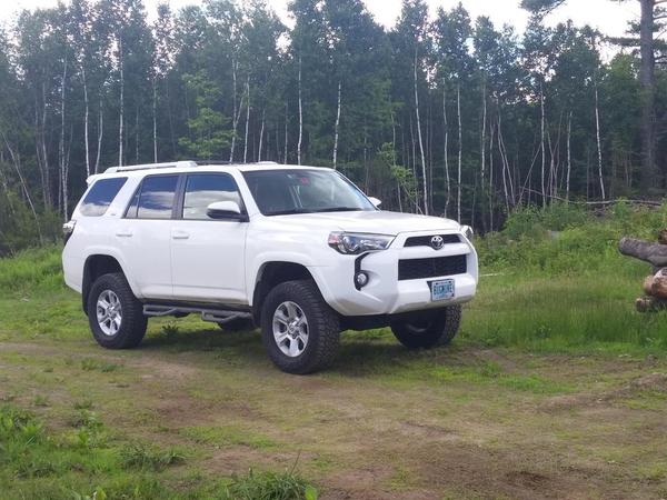

c59302c59325 c C59-302 2.5" front with C59-325 2" rear and Bilstein 5100's
Hello @Dobinson Mike. I am looking instal the same springs (c59-302 and c59-325) on my 2017 sr5. I care 100-140 lbs weight daily in the trunk. Is c59-325 good for it? I have shocks Bilstein 5100's already. My goal is 2,5" front and 2" rear. Do I need to do UCA, diff drop, rear brake hoses? TIA
Hey man. With that weight, you'll still be around the 2" mark on the rear, and it will ride well. No, you don't need any other parts, although UCA's do help the ride quality a lot on the front end at 2.5" of lift.
