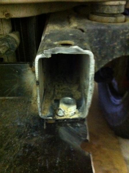

Cut frame ends off, drilled hole in the bottom and welded a nut to mount to.
