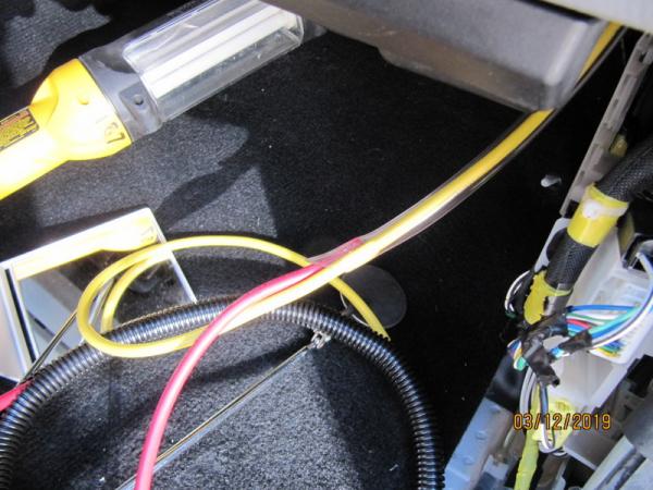

IM Using the clear tube insert the cable into the tube then pull the tube back out wire should remain in tube while pulling through grommet G 6225
