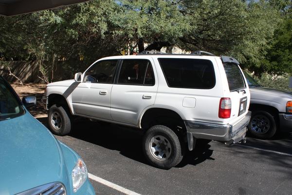

What lift is that where do you find it? I have a 96 looking to lift it. also did you have to remove the running boards to fit the wheels and tires?
Lift in that pic is OME 882 coils w/ OME 90004 struts in the front. 7.5 wrap LC coils and OEM LC shocks in the rear.
Go to my build thread and check it out.
I pieced my suspension together with used and new components. But go check out toyteclifts.com
Also, no I didn't need to remove the running boards to fit the wheels and tires, I just think they look stupid lol PM me if you have any other questions, thanks!
