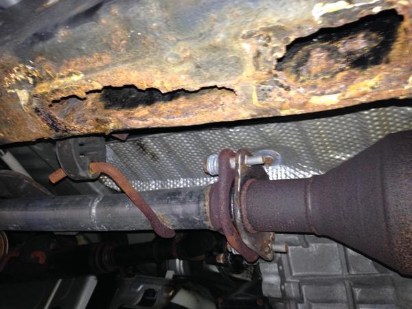

IMG 0574 Got some nasty frame rust below passenger side front door. Believe primary reason is originally the A/C condensate drain dumped right on top
  • Media owner rdruss
I hear you! Hopefully doesn't get much worse now that basic cause corrected.
Going to patch hole with aluminum patch/JB Weld and paint area with POR 15.
