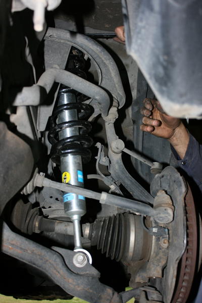

spehrparts, I just wanted to level out the front. I started with 2" of rake and wanted a level look. The FJ Cruiser coils are a thicker bar stock so they are a little stiffer and gave the rear a little less than 1/2" of lift. It's my daily driver and I only do mild off-roading so nothing to drastic. Love the new setup for sure!!!
I think I saw where you posted you took the Billy's up to 2.5" on the spring seat.
Did you see a bid difference between the 2" and 2.5" raise with the adjustable shocks?
I'm thinking about moving to that setting but worried about a lot of dive and roll during braking and banking.
Thanks!
FJC coils w/Bilstein 5100's installed
