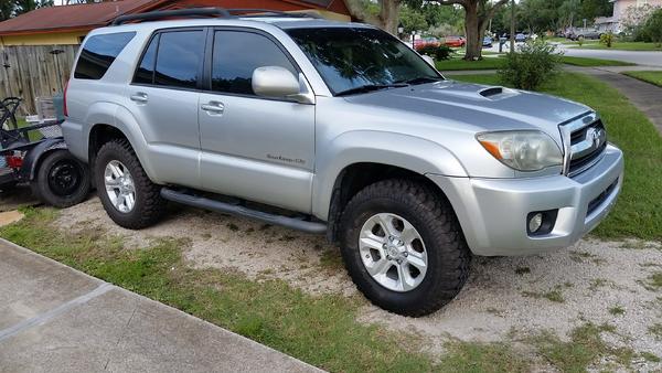

What lift do you have? I just bought an 06 SR5. I'm putting on the wheels you have from the 5th gen. I like the way yours looks. I'm not sure I want a 3" lift.
It looks a little different now. This was about 1" using some Tacoma front struts/springs and some FJ rears. Since then I put on 5100s set at 1.75 plus a rear spacer. Overall about a 2.75" lift. Any higher I'll have to start jacking with the UCAs and such.
