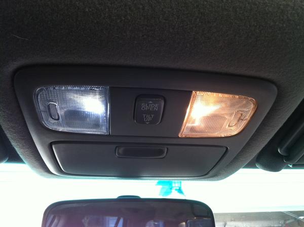

How did you get the plastic cover off? Im having a hard time, and would rather not break it.
I just stuck a very small blade screwdriver along the edge and carefully pried it out. I think it's attached in 4 places; they all just snap in.
