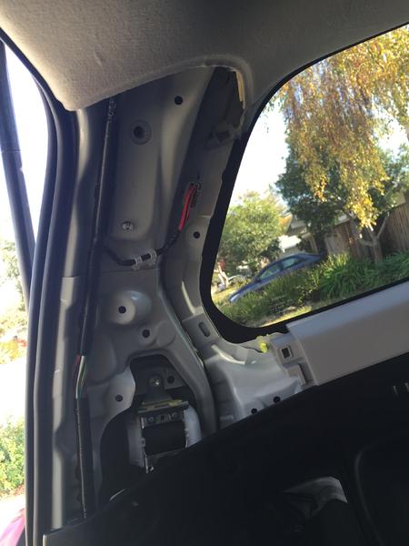

Step 12: Carefully pul back the lower black section enough to remove the upper belt cover housing. The belt should pull through the hole in the housi
