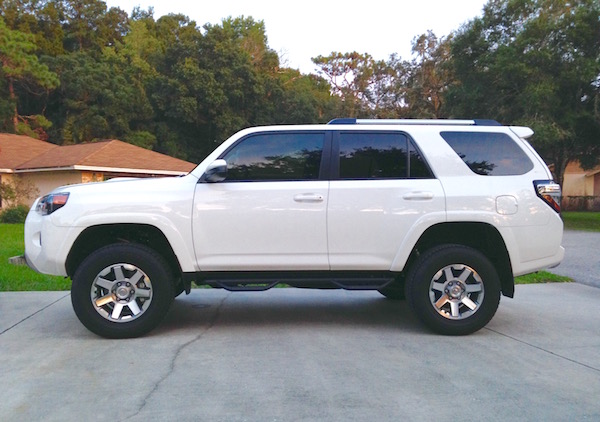

Hey, I just bought a 2016 Trail Premium a few days ago. Did you lift yours? And if so, can I do mine without losing the KDSS? Yours is super sexy by the way!
Mine is lifted and you can lift yours while maintaining the KDSS. Mine does not have KDSS, so I recommend you search the site and get a multitude of council. I went with Bilstein 5100's on all 4. 2.5 on the front with 2.0 Cornfed spacers on the rear. I had Camburg BJ UCA's installed on the front to eliminate any alignment issues. The ride is excellent. Firm yet smooth. I hope this has been helpful. Ron
