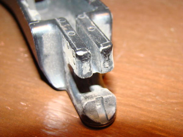

Toyota Rear Wiper Blade 004
The top is where you shave 1/4" off the two vertical faces. This will allow the arm to press further against the glass correcting the angle problem.
