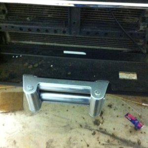

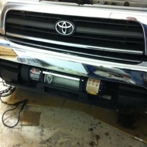

Winch in, the control box is right behind the bumper.

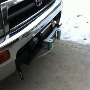

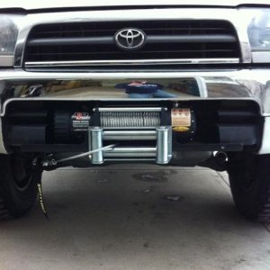

Fairlead on, going to replace with a low profile one and keep this one as a spare.

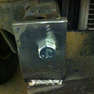

Bolt through bottom of frame rail.

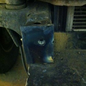

Welded mounting plate to frame end

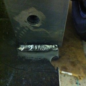

Cut frame ends off, drilled hole in the bottom and welded a nut to mount to.

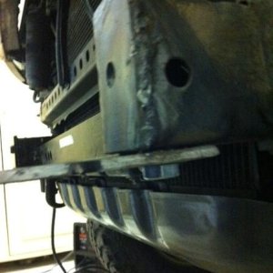

Starting Winch Install
