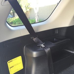

Optionally you can direct the belt through the side belt guide.
Last steps: reverse the steps to put back the housings, covers and tie down supports.

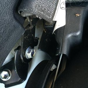

Step 16:  Install the lower belt support making sure the hook is under the protrusion.
Step 1:  Lift rear most tie downs on both sides and pry up bolt cover.
Step 2:  Remove bolts from both sides.
Step 3:  remove the tie down assembly.
Step 4:  Remove the rear cover and set aside.
Step 5: Carefully pry up side cover and set aside.
This is what it looks like with the side cover removed.
Left side removing with ratchet wrench.
Step 8: Pry off the upper seat belt access cover.
Step 9:  Remove the upper belt support.
Step 10:  Twist the net support and remove it.
Box with Left 3rd row belt
Left belt assembly
Left belt assembly
