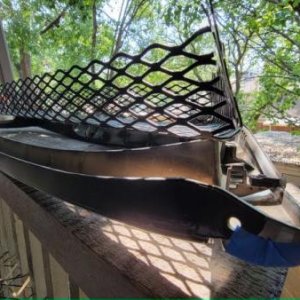

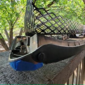

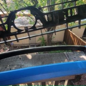

Could be worse! This is the Diamond XXL mesh from customcargrills.com.

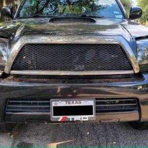

It'll fit, though. It's a 1st try.
From either side
From either side
Note here that I did not

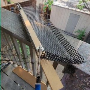

Make sure you find a way to account for the curvature of the grill shape.
I cut the mesh before bending it. Don't do this. Bend 1st, then cut.

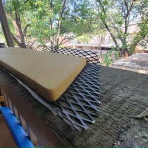

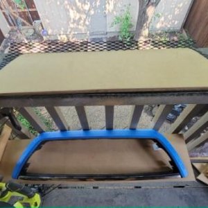

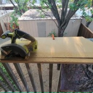

This is MDM board from Home Depot, 3/4" thickness.
The difficulty with this grill is the shape... note the curvature of all faces.
No turning back now...

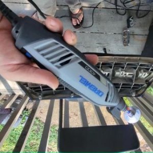

I used a Dremel, don't. Use a jigsaw.

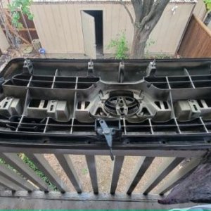

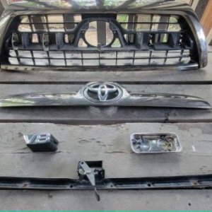

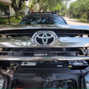

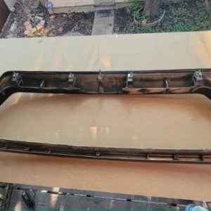

OEM grill, torn down

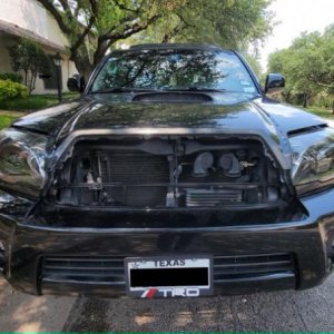

Like a hockey player without a mouthguard

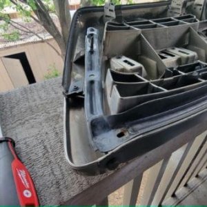

Access to 10mm & Phillips screws is awkward
Original grill
Original grill
