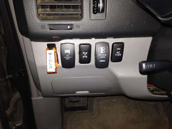

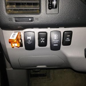

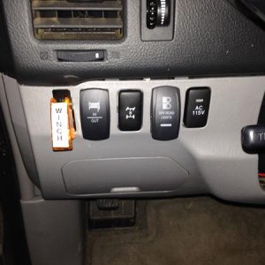

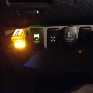

Winch Control
The in/out switch is a momentary switch to pull winch line in or out. You have to hold it down to keep the line coming in/out. The yellow switch on the left is to arm the winch control. It prevent you from accidentally starting the winch by bumping the in/out switch.
