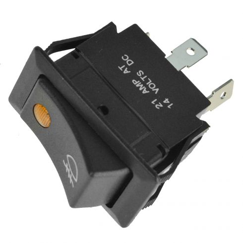

Hello,
I recently purchased some off-road lights. They came with wiring harness and relay. Im connecting this to a oem foglight switch with the little orange led. There are 3 prongs on back of switch. Top=Ground Middle= Hot Bottom= Out to relay How do I wire this so that the little orange LED lights up when I turn on the truck? Right now, it lights up only when I flip the switch to turn on lights. The aftermarket off-road lights switch wiring is Black, White, Blue Any feedback is greatly appreciated! Thanks |

It might be possible if you wire the top and middle terminals the opposite way. Is that the switch Oznium sells?
From Customer Questions: Scion OEM Style LED Lighted Rocker Quote:
Quote:
Terminals Top= Ground Middle= Hot Bottom= Relay/lights So, I should move the middle white wire to top terminal (ground), and the top black wire to middle terminal hot? |
