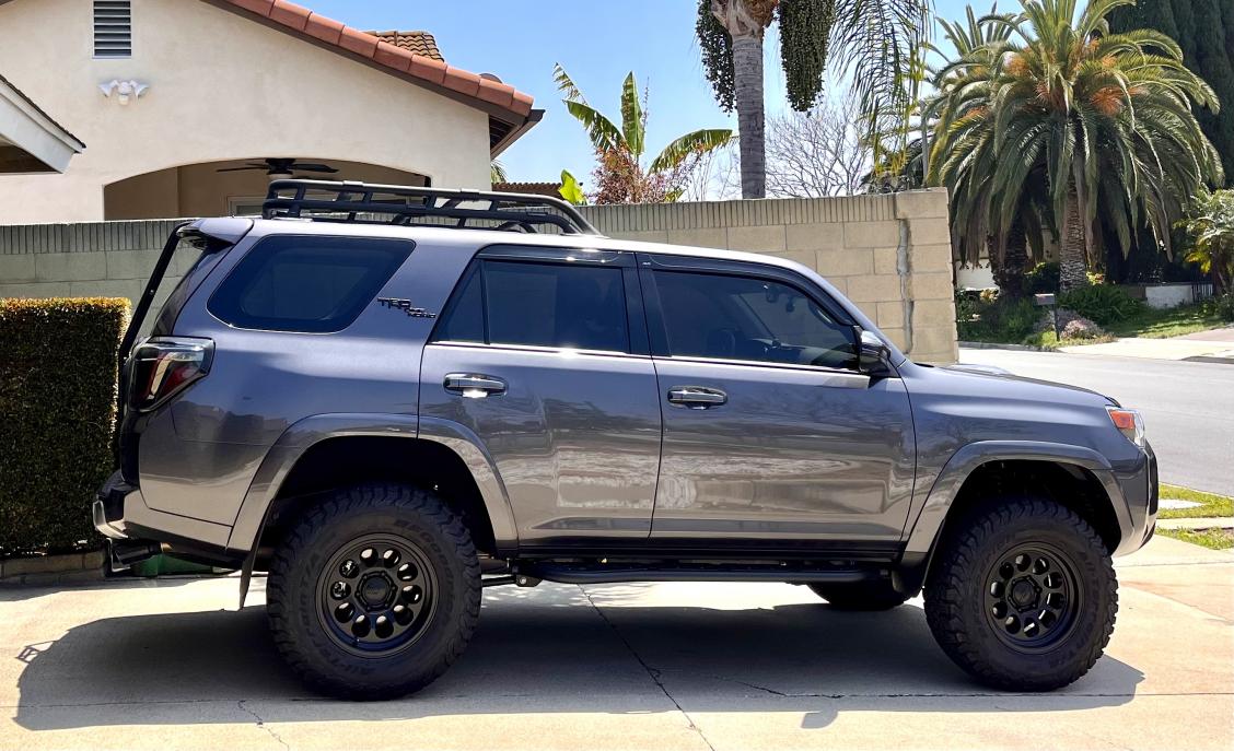

1 Attachment(s)
Bilstein 5100 F/R (front clip is on the lowest setting, 2.75), Bilstein rear springs 1.5, OME 2887 front springs and trim packer to compensate for the lean. SCS 17X8.5 -10 w 285/70r17 K02. No rubbing. I just trimmed the front bumper (inner lip) and mud guard.
