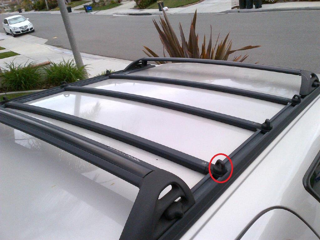

Anyone know the size and length of the roof rack bolts for the cross bars? Circled in red below. Not wanting the thumb screw part. Just a standard bolt.
Would prefer one that's theft proof.
Attachment 227066

I want to say it's a 10mm?
The length will be dependent on the thickness of whatever your mounting to the roof,
but I recall I used whatever the typical OEM 10mm bolt is for mounting a 1/8" rack foot.

It's M6. I used M6 x 15 to make my low pro mounts.

Thanks That's the info I'm looking for. Did you screw them into the stock track nuts?
I've got some 10 gauge steel mounts for my high lift I'm needing to bolt down.

Yep. I reused the stock track nuts.
