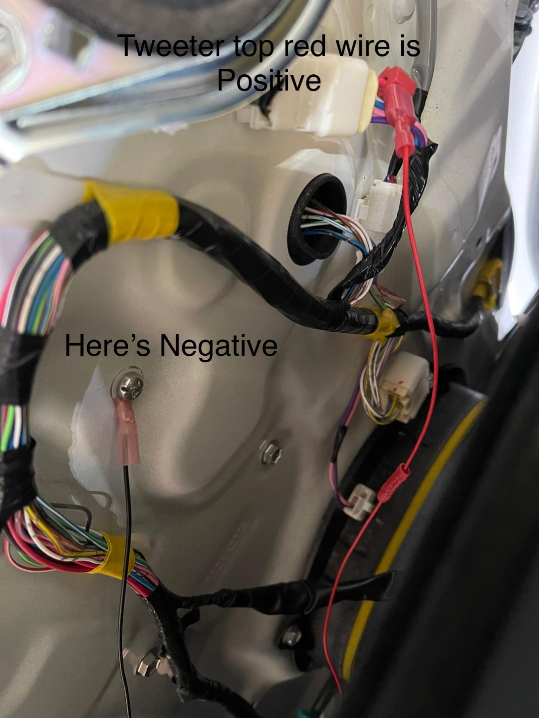

I was finally able to do this little project today. Thanks to Bluesky 07 who started this thread and who generously donated his extra RadioShack blub to me a few months back.
Making the hole to mount the bulb was a bit of a challenge due to limited space, unless one had a small size drill. I used a right angle drill with a 9/32 bit. I also got the positive wire connection from the tweeter top wire harness as shown in picture. The negative could be connected to any of 4 screws attached to door frame, also shown here. Thanks a lot Bluesky 07! |
