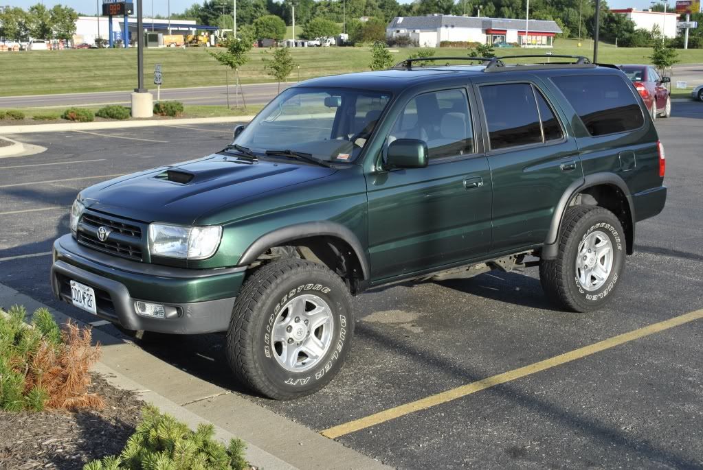

Specs on my 1999 SR5 Highlander when I bought it:
-Factory tall coils
-Bilstein HD shocks
-RR Diff Locker
-Rocky Road Supersliders
-BudBuilt IFS and Belly skids
-Crager Soft 8 wheels
-265/75R16 BFGoodrich Mud Terrain KM1's
-SS Extreme Duty Rear Lower Links
It also came with:
-Factory 5-star alloys
-265/75R16 Bridgestone Revo's
-Factory running boards
-Husky floor liners
This is a picture from the drive home right after I bought it. The back was loaded with the Crager/BFG combo, running boards, etc.

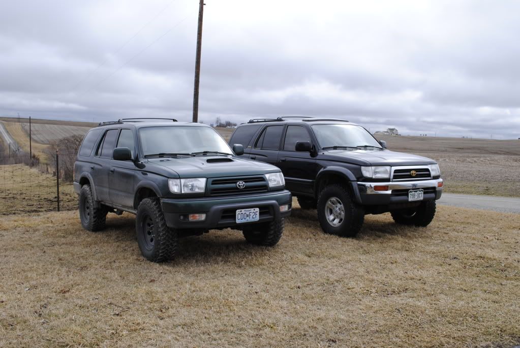

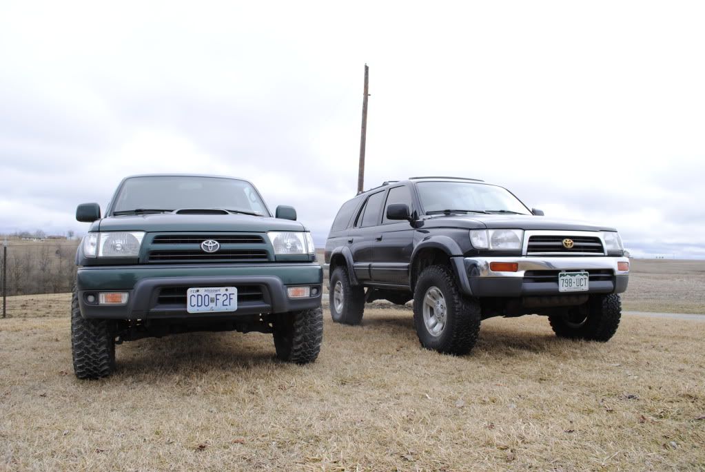

Both 'runners together before the '96 Limited left for Colorado
http://img.photobucket.com/albums/v1...2.jpg~original
http://img.photobucket.com/albums/v1...5.jpg~original

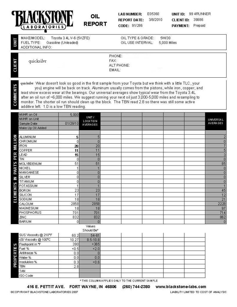

First UOA (Used Oil Analysis)
http://img.photobucket.com/albums/v1...d.jpg~original
Wasn't too thrilled with this first UOA, but in hindsight, the oil probably had like 7000+ miles on it. And I have no clue what brand it was. I should have had it changed at a quicklube before I drove 1300 miles home on it. Anyway. I thought I might have some issues, and was kind of feeling down about the truck overall after getting it home, going through everything and having this first UOA done. But, I have since done 2 more UOA's, and everything looks great now. I have a strong engine that is showing normal/low wear, and I expect lots of life out of it.

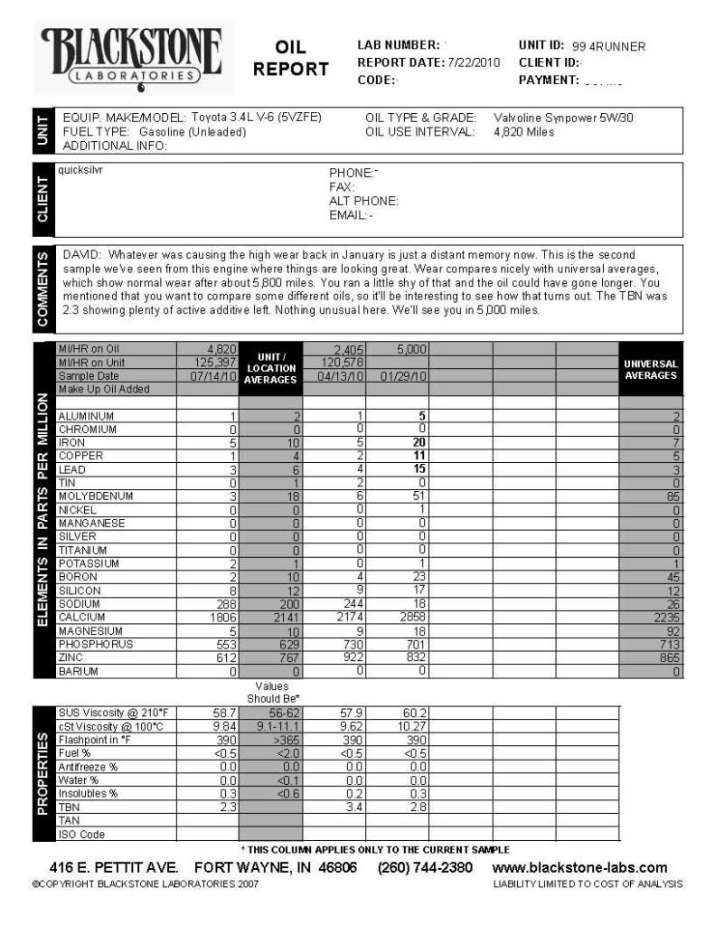

Here is my most recent UOA (you can see all previous UOA on the sheet)
http://img.photobucket.com/albums/v1...t.jpg~original

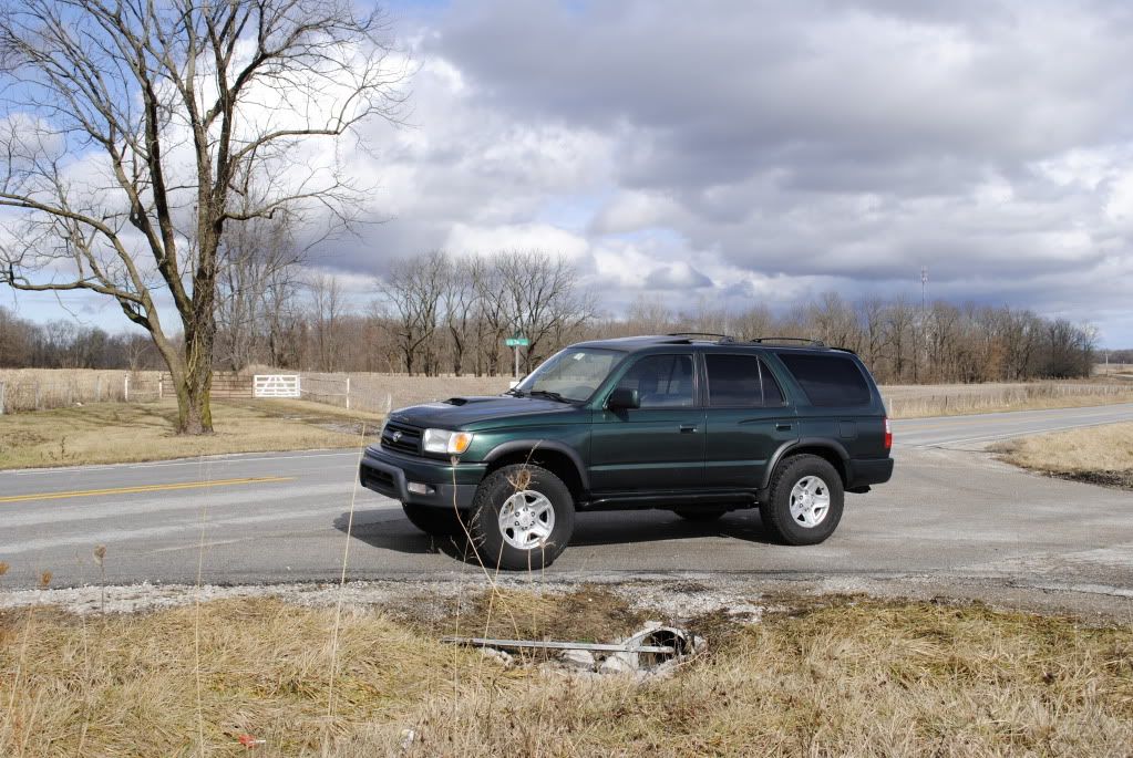

Currently (6/30/2010):
Looks pretty stock right now. I snapped these real fast today, the lighting sucks and the setting sucks....but it's better than nothing right?

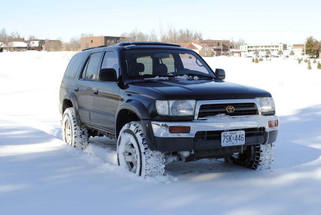

Some winter pictures, January 2011.
http://img.photobucket.com/albums/v1...4.jpg~original
http://img.photobucket.com/albums/v1...3.jpg~original

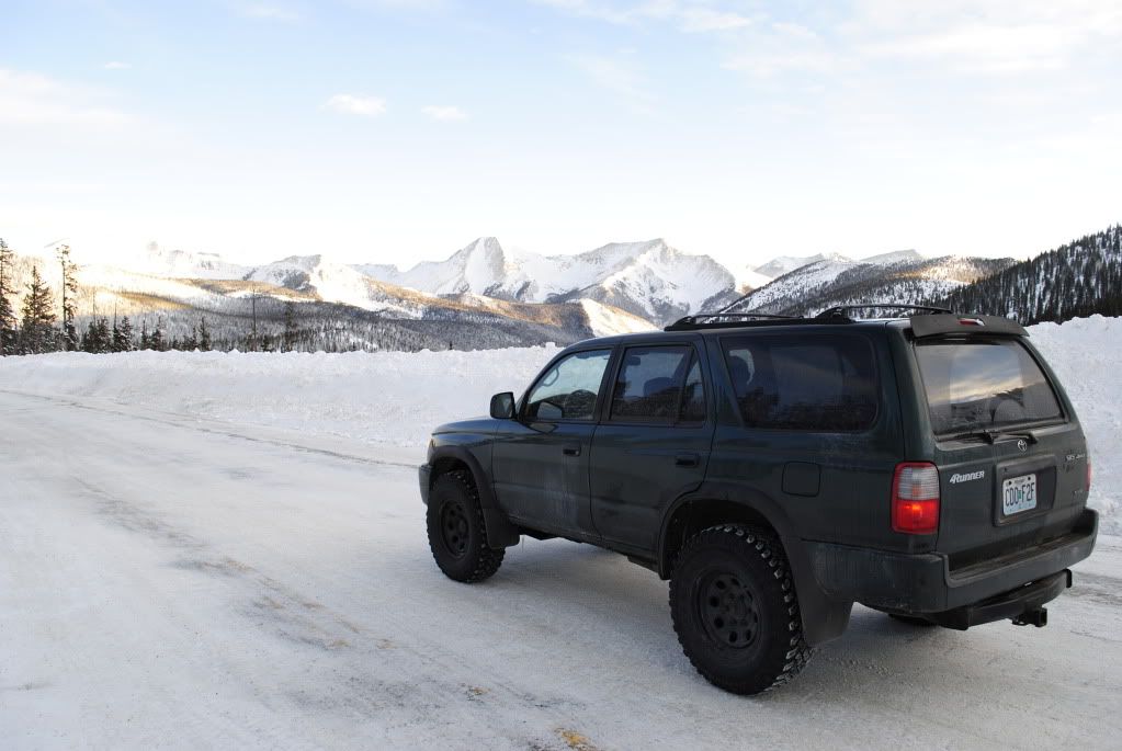

Ski trip to Colorado...
http://img.photobucket.com/albums/v1...0.jpg~original
