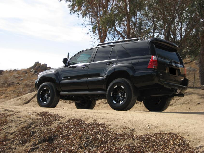

07 Blk Sport w/ Cornfed 3/2 lift
I have been taking my 4runner with the Cornfed lift into my dealership for over a year and so far no negative feedback, only compliments.

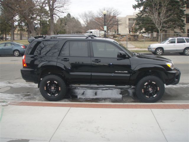

I've been lurking around here for a while and after reading a few of the posts about spacer kits, well I decided to take the plunge. I had a Cornfed 3/2 spacer lift. Tires are BFG 285/70R17 on Moto Metal 951's w/4.5 BS and -12mm offset. I experienced alot of rubbing at first, but I trimmed a little of the fender and now it only rubs very little when the turning full left or right, when I backup.
Thanks to the guys that have done similiar installs in the past to give me the confidence to lift mine!

I got it from Jason Burtman at the link below for 300.00 approx and I had the local Big o tire shop install it. They charged $350.00 including the alignment. I think it was a good deal since I was not willing to deal with the X-REAS suspension, which remanings intact.
http://www.burtmanindustries.com/zoomprod.php?id=4run_03_up_liftkit
Also, the tires were $1100 installed and the wheels were about $1000. Keep in mind that I bought 5 of each.

I would think that a V6 at sea level would have as much power as my V8 at 6000 ft elevation. 3% power loss per each 1000ft gain in elevation. I know when I get around 12,000 to 14,000 ft my drop in power is pretty significiant. But thats going to be expected.
I real don't think you'll have any issues. Maybe some others will chime in on this.
As for trimming, I had to trim quite a bit of the front bumper off near the front of the tire and the fender liner as well.
Since you bought 5 were you able to mount that size spare under the vehicle still? How is the ride of the CF lift with the Xreas still?
I didn't even try to mount it under there. As I understand it from reading other posts, it won't fit.
As for the CF lift and XREAS, the ride is a little frim, but I traded a lifted 01 Jeep TJ fro the 4runner. You could say I'm use to a vehicle that has firm suspension.
