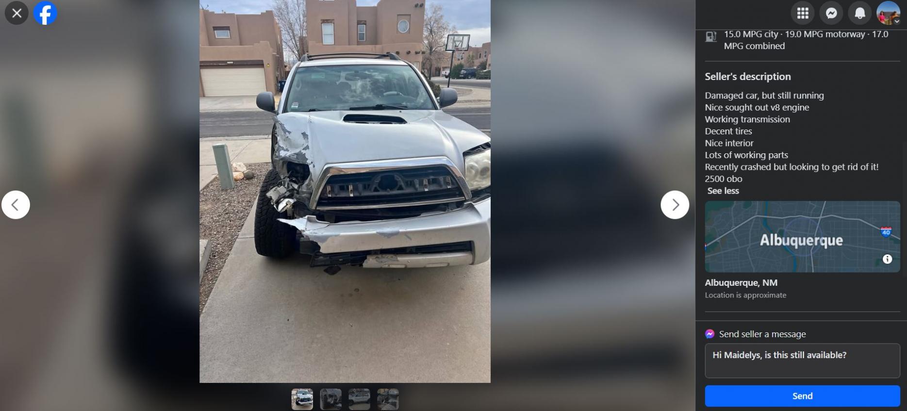

My local FB marketplace has this entire car for $2500 Log into Facebook
