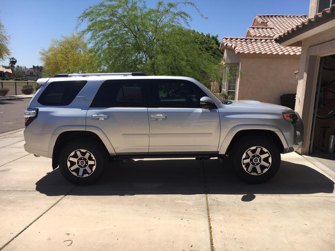

First my truck stock:

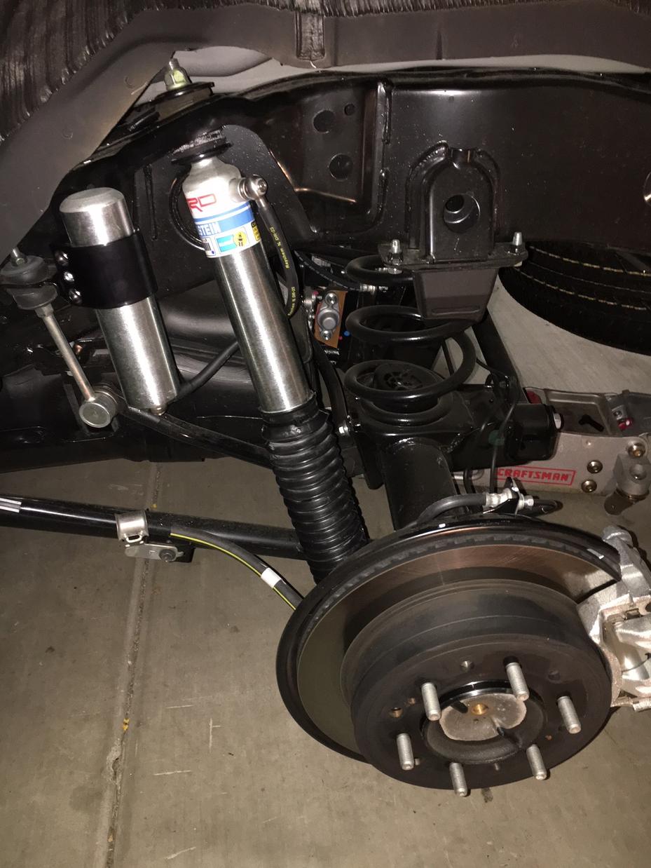

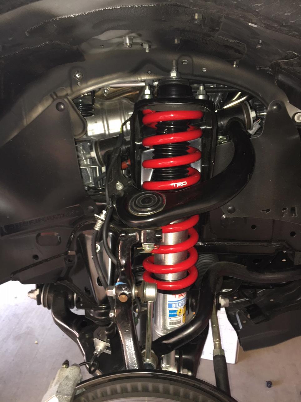

Front and Rear TRD suspension. This suspension is great! The stock ride felt "jittery." It was too bouncy and unsettled. My 06 had Bilsteins, so I was probably just used to a good ride. I bought the discontinued FJ kit, so it was only $570 shipped. I went with this to avoid a warranty issues with the dealership. I can also go with a higher bilstein lift down the road for something different. Really good improvement and I like the red springs and reservoir on back shocks. Just looks cool.

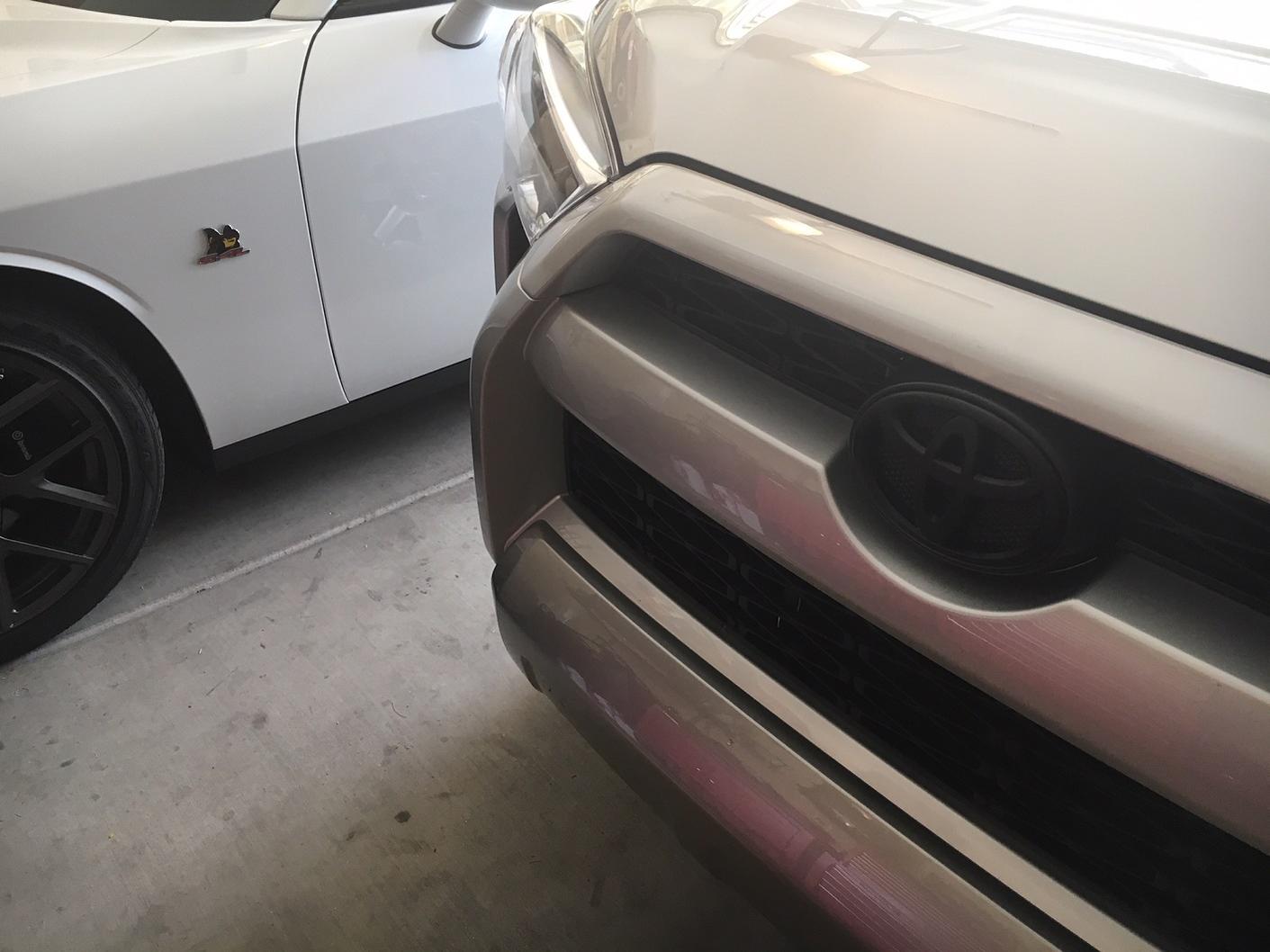

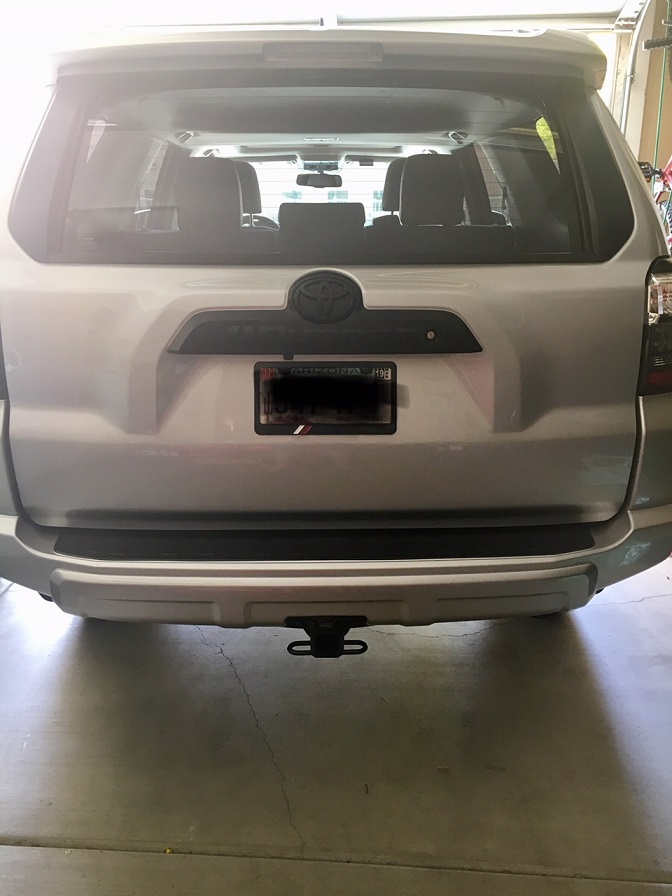

Installed the black out kit. I've had plastidip in the past, and I don't like how it looks after a while, so I just bought the kit. I'm leaving the silver badges on the side, I like the contrasting silver colors

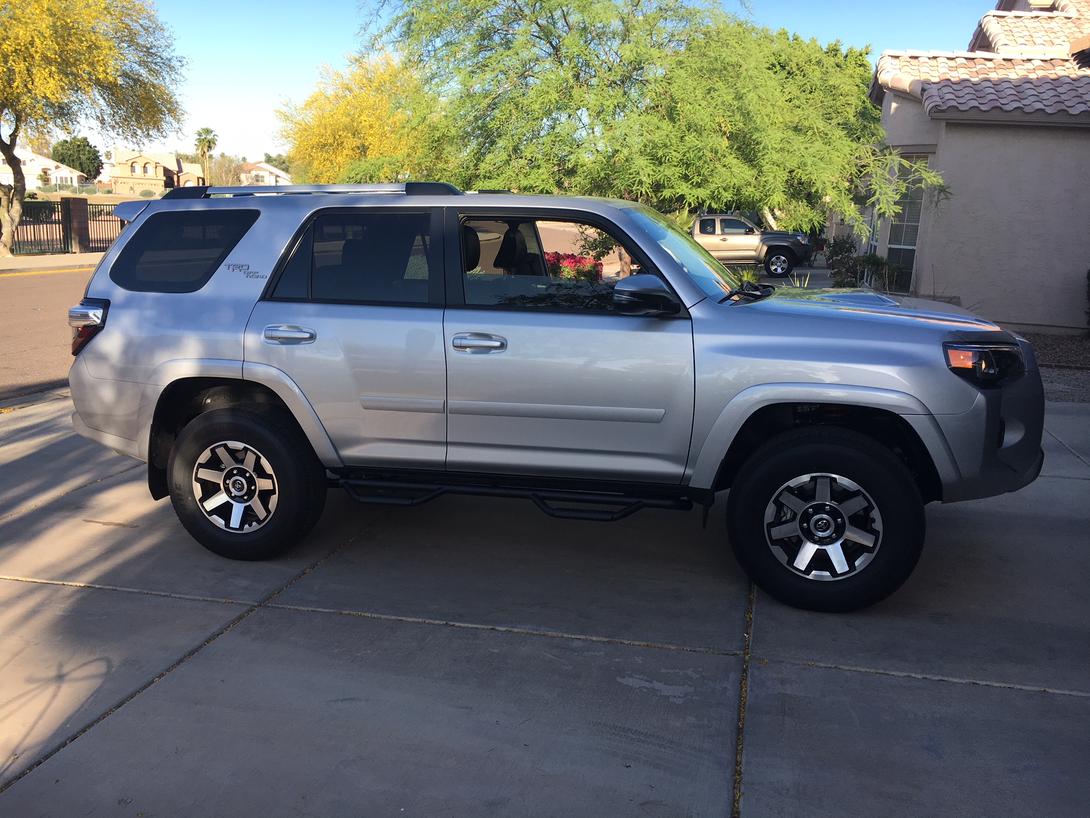

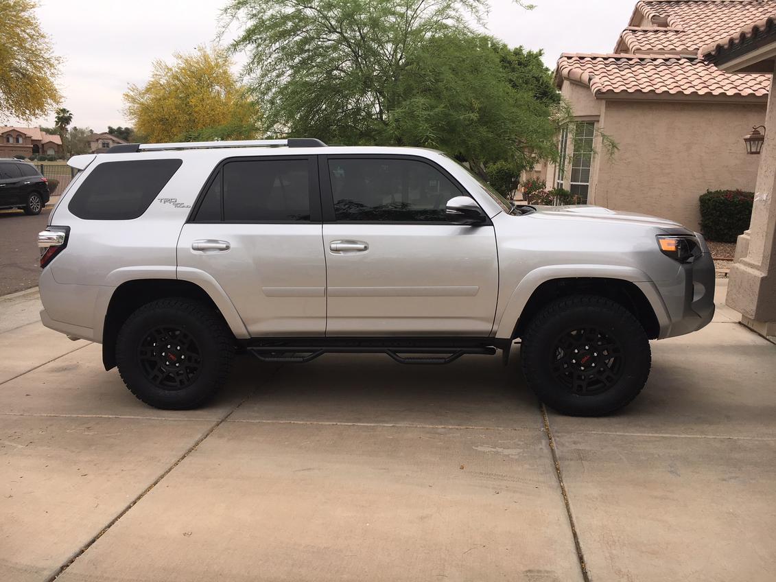

Put on the N-Fab steps. I don't like how much they seem to compromise ground clearance, but my son and wife actually need the step. Besides, the gas tank and other undercarriage parts sit pretty low.

The side steps look good.

No, installed myself. It's not bad at all. Neighbor helped me. Took my time, about an hour per side in the front since I switched out the top hats. Back was easy too. Took me a little bit to figure out how to orient the reservoir and everything. It's soooo nice working on suspension on a brand new car. Everything is so clean; all the bolts come right off.
