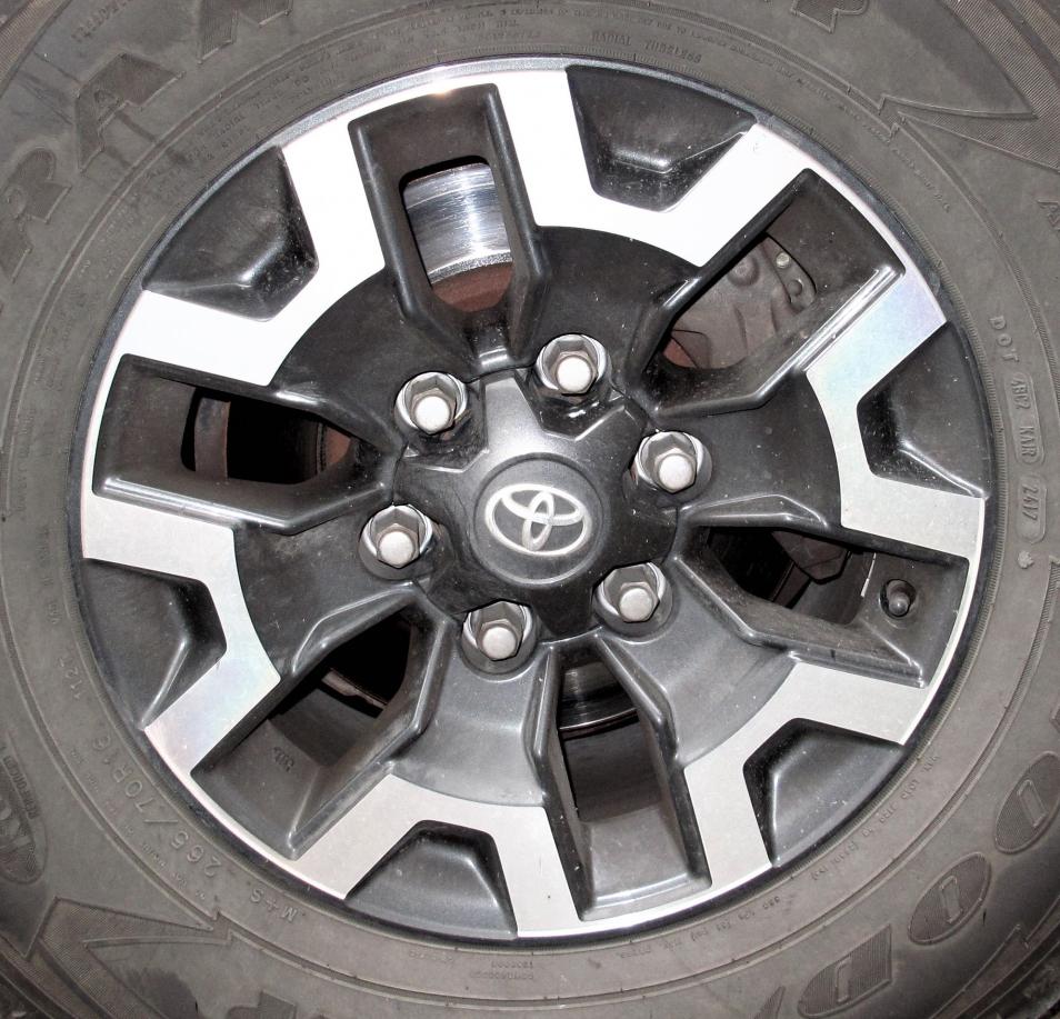

13WL and Toyota rim 75189
Will the Toyota rim 75189 fit over the 13WL caliper ?
Hoping this will work on my 2002 4Runner.
Thanks.

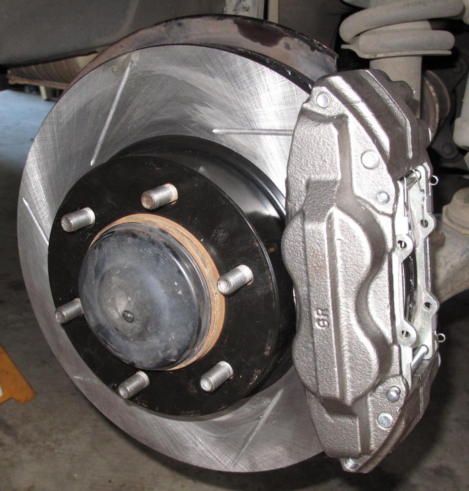

Update. Been ill for a couple of days so I tryed flxing me muscles and doing some wrenching. Got the 17mm bolts loosened ready for full on attack tomorrow.
BUT, what's this all about then ?
I use a 12mm flare wrench to loosen hydraulic lines, but the other side has a 10mm flare !! Something's happened before I owned this car.
Will dig deeper in the morning.
Thinking I might upgrade flex pipes and put in long items from top connection, leave out the solid pipe into the calliper.
Is this a silly idea ?

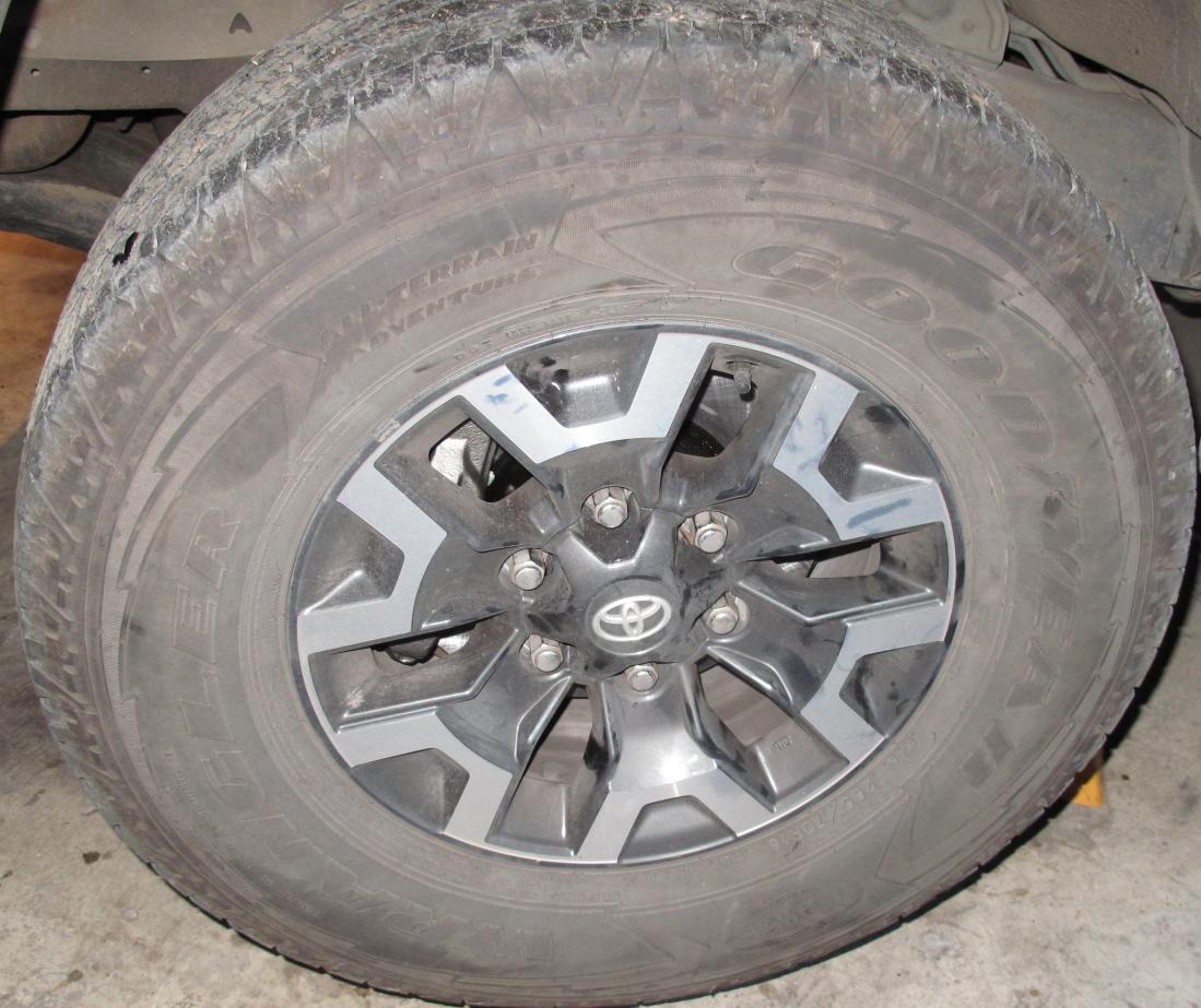

Completed today on tail end of fever. The pipes were OK, just some mikey mousery by previous owner, forgivable in my book. Thanks for the comment Medic. Used OReilley reman calipers. Came in two different sized boxes, by two different reman shops prolly, they looked alright as could be determined by eye. Everything installed with minimal grunt, just one of the hydraulic line input ports was rough and needed patience. It leaked a tiny amount first time through the bleed but settled when I freed it then re-tightened.
Bleeding couldn't remove a soggy feel on instant pedal pressure, would firm up on second and third push, good enough find the rims fit so time to hit the road to bed in pads.
Soggy feel was a bit disconcerting but the brakes !! Blimee, didn't take much to prove to me that this is a great upgrade. Then fever called me to the couch for the day.

Running out today, even with out 100% functionality, the truth is that these are the brakes that should have been put on the car originally. It will stand on its nose now !!
So happy and glad to have done this upgrade. Now the system is 100% with a good bleed done, I can tell you this is how 4Runner brakes should have been from the start. When I really dive on the brakes, it is a linear activity. Not like it was where after the first 3 seconds and the brakes show fade and put your heart in your mouth. No, it's consistent to the stop now and repeatable straight after.
